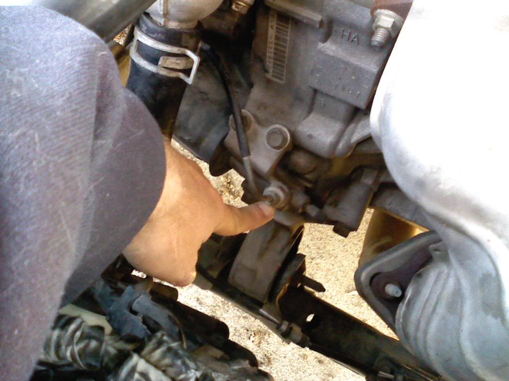

Sounds like a broken clutch cable/ link. If you have an hydraulic clutch check for leaks at the clutch master cylinder and slave cylinder. Start at the slave cylinder, that's usually the first to break.
The slave cylinder has a metal line going to it and is on the clutch casing. I have a 7th gen but, yours should look similar:
