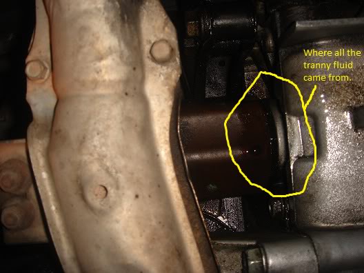

Sorry guys if this answer is on here somewhere im just covered in tranny fluid and need some help. Just throw this out here right away i have worked on many rear wheel drive cars and can do about anything on them. This is my first honda and first front wheel drive vehicle. About three days ago i came across a 99 civic hatch dx for 1900 bucks. Went to look at it and found out it was a rebuilt salvage title and it has 196k. Motor was installed and only has 50k. It is the d16y7 motor (stock) with a manual tranny. It drove fine when i test drove it. So i talked him down to 1300 bucks and i drove away with my first honda.
The next day it started to make a clunking noise sporadically when accelerating. Stoppped driving it and went to honda to buy a few quarts of HTF. (honda dealer told me it took 2.7 quarts). Got it up on jack stands (its leaking pretty badly at this point). Took off the fill bolt first the then the drain plug. Only about a half quart came out. Put the drain plug back in put about 2.7 quarts in it then it slowly started leaking out the fill plug. Pulled out the funnel tube and 2 seconds later it all leaked out the driver side of the tranny (i belive its the axle shaft).
Please help me! Am i needing to do a tranny here? what happened all of a sudden?
I attached a pic of the leak its on the driver side of the tranny you can see the exhaust in the pic.

Re: Help....clunking then I filled tranny fluid and it leaked out the axle?
Bad axle seal.
