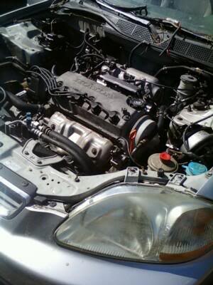

That's odd... Physically the engine looks about the same. There were slight differences such as the fuel rail having the connection on top rather than on the side, stuff like that.. I just figured it was from a later model, such as a 99-00..
The motor was advertised as a Japanese Domestic Motor... Would that be the difference? And if I truly do need a new computer, would the current one even be running the car like it is? I really don't know, that's why I'm asking..
But literally everything lined up. We even used the old distributor since the wire connection was different.. When we first went to fire it up it just turned over. When we rotated the rotor 180 degrees it fired right up and ran great! Really surprised me and my buddy that was helping..
The best I can muster up is a grainy cell phone picture right now... It's dark here in FL but I'll try to take a better one tomorrow...

that is not a 01 engine. Maybe it is a JDM engine the computer needs tuning (reflash)or a new one to match.

Actually it does appear to be a 6G ('96-00) from the picture. Please look for the plaque area stating the exact engine series. Since it's a JDM 6G engine your ECU should be ok and you just need to sort out the running issues.
