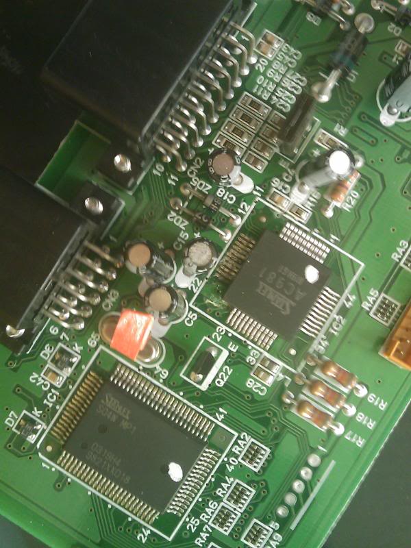

Well i replaced the blower motor resistor and that didnt fix the problem, so i checked the motor by hardwiring it to my battery and it works great. So after a long period pf testing all the wires i think i have found the problem. The picture below is the silicon chip that is inside the nobb/control box for the blower and there are several spots where it has blacked out and crusted over circuits. So i am thinking i will need a new one. I will most likely not be able to buy just the chip. So i was wondering what the box that houses the chip and the nobbs for adjusting the blower and heat is called and where i might find it.

usually ebay sells those ***** and dial pieces for cheap. its easier to just get new parts than to worry about fixing it. you might try wiping the crusted or black areas with alcohol and see if that makes it work first.
