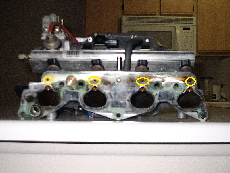

Sorry to bring back an old thread, but I'm having the same problem. Where are the air injection holes on the intake manifold? Thanks!

Re: High idle on D16y8 replacment motor, hours of toruble shooting, no fix yet
The holes are circled in yellow. Plug them with JB Weld.
