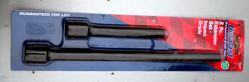

Is this the part you bought from Autozone?
http://www.autozone.com/ratchets-soc...et/390933_0_0/
They don't list a torque rating on their web page. If it worked for you then it may work for me, lol.
That looks about right except it doesn't specify that it's impact rated. I just grabbed whatever they had in the store. Pep Boys, Home Depot, Lowe's, Sears would all have what you need. It's all made by the same few manufactures over seas and will do just fine for what you need.

Found em, impact rated, going to pick up today... yeeha
http://www.autozone.com/ratchets-soc...et/914182_0_0/
Used em... Thanks GolNat! These worked great. My buddy's 135lb compressor & impact driver didn't budge the nut. Duralast rocks! Used a 4' hydraulic floor jack handle on the breaker bar and the nut broke loose with a loud crack, just like you I started looking for something broken lol, and as you said, Duralast has a lifetime warranty. Great tools, thanks again for the referral.

That's the set I bought.
Lol, it's a scary sound when she breaks loose!!
Awesome, glad it worked
