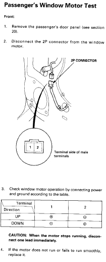

Regarding the problem with the front passenger power window, it's pretty clear that the switch is fine. Based on all the information, I believe that the likely culprit is the front passenger window motor. I had to replace two such window motors in a 1998 Toyota Sienna, and the symptoms were very similar to those you have described.
The attached file describes how to test a Civic passenger window motor for defects. I hope this information helps.
By the way, did you figure out the problem with the front driver window?

I'll do my best to explain the motor test and the good suggestion made by Nitri Express.
The motor test illustrated in the picture I posted tells you to bypass the power window switch on the door by disconnecting the 2P connector and then to provide a separate 12V power source directly to the window motor. The motor should move the window up or down depending on the polarity of the + or - wires from the power source to the 2P connector. If the window motor does not operate as expected, then it should be replaced.
Nitri Express' suggestion (I believe) is that you also verify that the power switch is working properly by disconnecting the 2P connector and showing that you detect proper voltage from the switch-side of the 2P connector when you press the power window switch in either the up or down position. The tool used to perform this simple test is an inexpensive Multimeter that you can purchase from any hardware store. The answer about load vs no-load is testing window motor operation when the motor is either moving a window (load) or disconnected from a window (no load).
With all this said, I believe that the motor is likely your problem. To test this, you could also purchase a replacement motor from your local auto parts chain (carefully unpackage and save all packaging in case you need to return part) and install it. If the window now works, then you are done. If the window does not work (unlikely), return for a refund and simply tell them that the part was not needed.
Your other problem with the driver window alignment is likely the regulator. Check for any loose or broken parts. Comparing operation of the driver and passenger side regulator may help you figure out the problem.

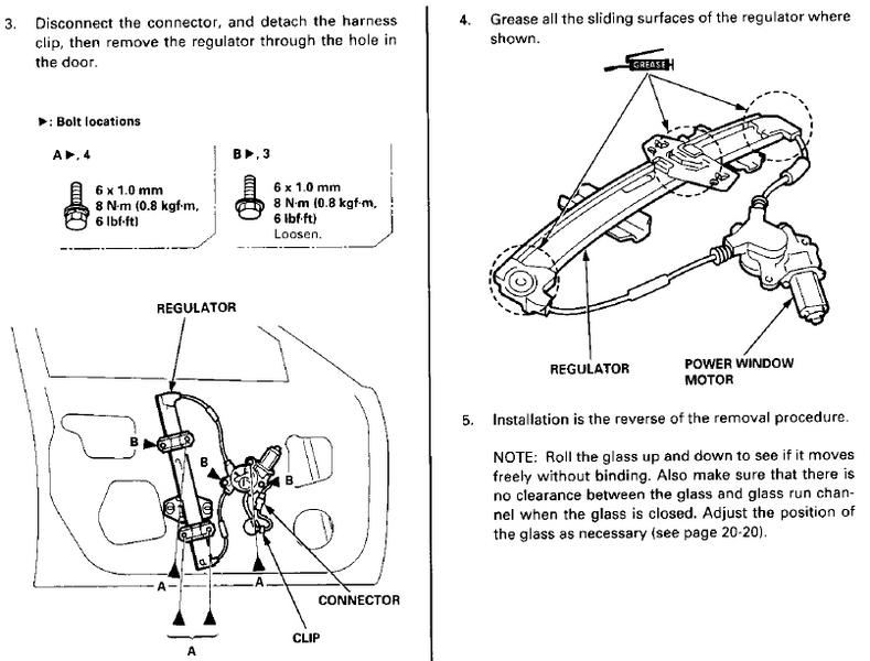

By the way, here is a picture of the window regulator in your door:
