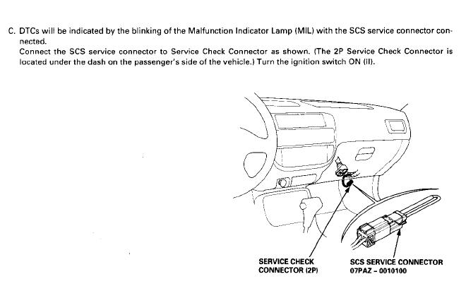

Re: 97 Civic Maintnence Light
Locate the SCS connector behind the passenger kick panel. Then jumper the 2 pins in the connector using a paper clip (or any other suitable metal conductor) instead of the special Honda tool. The turn on your ignition to position II and count the long and short blinks of the Check Engine Light to get the 2 digit Diagnotic Trouble Code.
