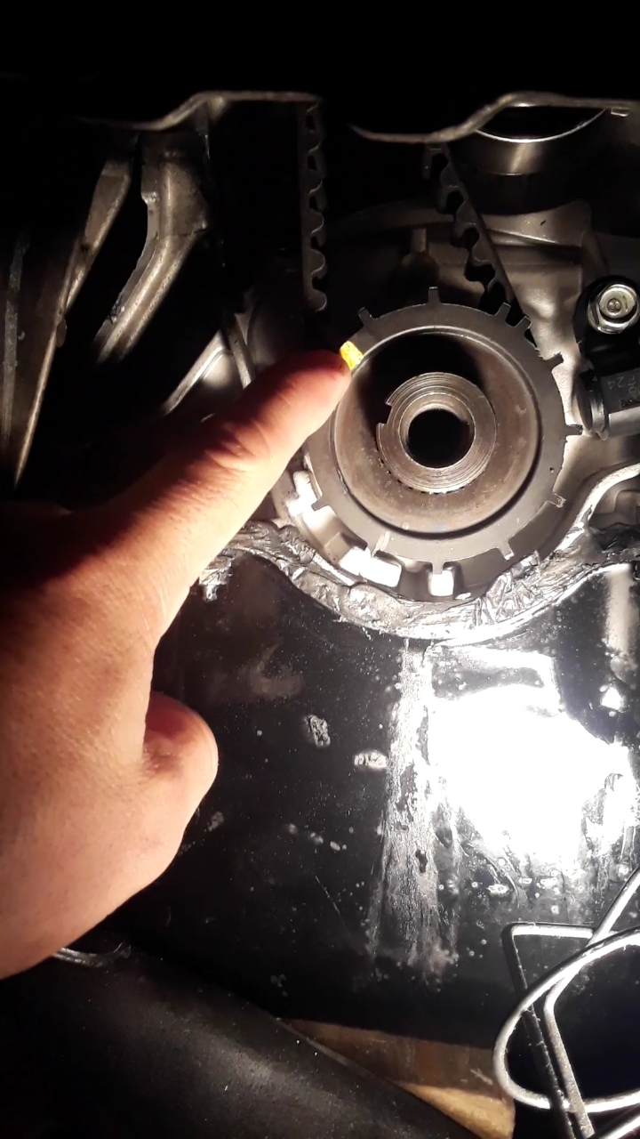

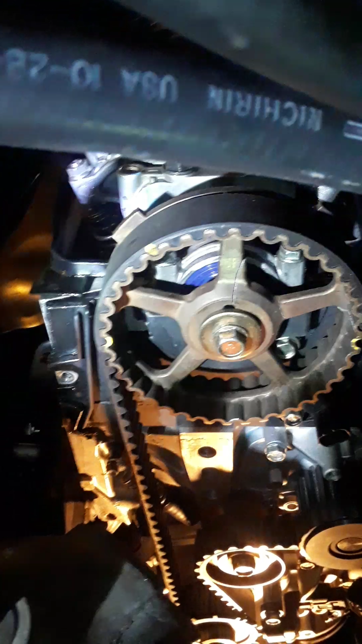

#1- the cam sprocket at TDC(broken, will not turn valve train)
#2- the crank shaft
the cam sprocket still turns with the crank shaft
the car ran for about 3 mins and died. The pucs are what I found. One single thought came to my mind. What do you tjink??????

Pic of cam gear looks like it cracked where the alignment pin is?
Did the camshaft seize in the head? (galled journal?)
Did the cam gear bolt just come loose (or forgot to tighten it) and the gear spun?
Have you taken anything else apart yet to find out more?
Got any history on that engine?
Did the ever get badly overheated and warp the head?
Any other major events ever happen to it?

I want an initial response with the limited info I gave. The sprocket still turns with the crank. It will not operate the valve train though. The history is not relevant for what I am asking. What is your initial thought???? If I give more info then your opinion/thought/cause might be swayed. I will say this much more. I turned the crank to get the sprocket to TDC.

Prove the pulleys are really out of time. Set crank on its TDC mark, and then see just how far off the cam gear is.

The cam IS at TDC so the crank should be too. But it is not. I am even pointing at the TDC mark. That is why I said look closer at pics.
INFO +pics
-the cam key and sprocket are broken
- the sprocket still turns with crank
-the belt is not shredded
-when the sprocket is at TDC the crank is off TDC by about 70°
Our first thought, the timing was wrong from get go.
Our logic--
Since the belt is not shredded and the sprocket IS broke then the belt did not jump. If the sprocket had not been broke then I would be more tempted to believe that it might have jumped. But then again; it would have to jump 15 teeth(guessing). Seems like that is a bit too much to jump before shutting down. The sprocket/key way broke because the belt was stronger. So, if it were timed right - placing the sprocket or crank at TDC would put the other at TDC. As you can see the crank is off. Logically makes sense to me and this other guy I showed the video to. Not saying I am right but really seems sound to me. What do y'll think???????

I only saw it broken around the center and the pin area. That means it's free to spin on the end of the camshaft.
Is the outer ring of the gear (toothed area) also broken?
It's pretty apparent in your picture that it did jump time.
Could have been when the cam locked up and sheared the pin/broke the gear?
Could have been when you turned the crank clockwise?
So is the camshaft locked up?

I am not saying that it was off by that much from begining. Just wrong time. My bad, didnt really mean to imply that it was off by that much from get go. I know that my civic according to my scanner can advance spark by up to 40° if I remember correctly. So, if they were of by two or three teeth the computer could still compensate but once the car eventually goes too far out of time the ecu cannot compensate and or just hit the wrong time and by that time the timing is off by that many degrees. I can see it in my head. You know the timing slowly moving out of time until eventually hits the wrong time. Don't know if I explained it right though.
lol, I didn't turn it clockwise and I didnt turn it much. The sprocket was about 20 ° off. I turned it CC. Nice try though.
the sprocket is broken across (perpendicular) the teeth but still holding together and still spins on the cam shaft.
I don't believe the cam is seized. I don't want to take anything else apart so they can't say I messed with something.
