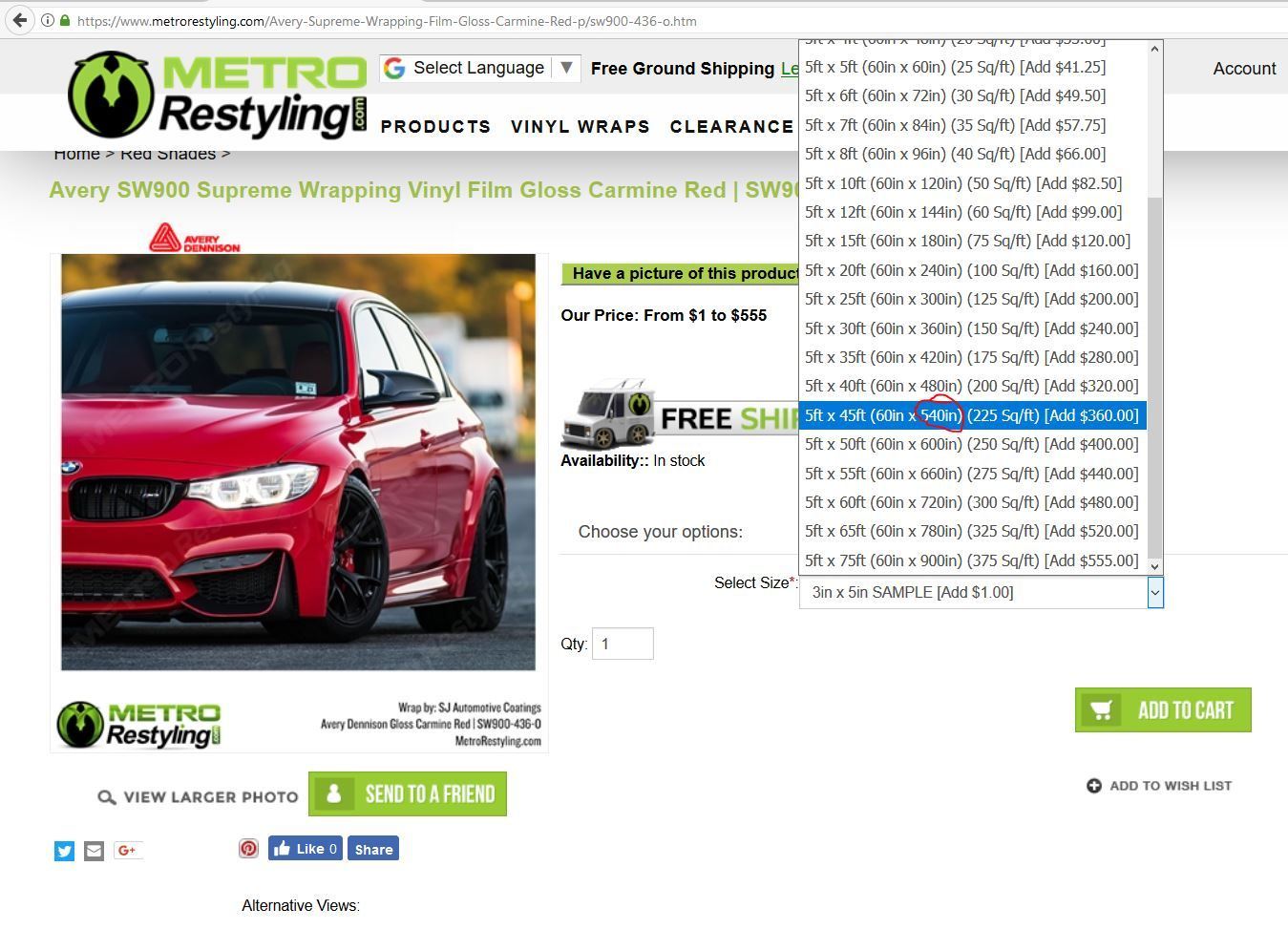

wrapping a car you generally measure the length of the vehicle and multiply by three to get a good estimate of the material you'll need.
174.6 * 3 = 523.8", then you pick the next size up, so 540"
