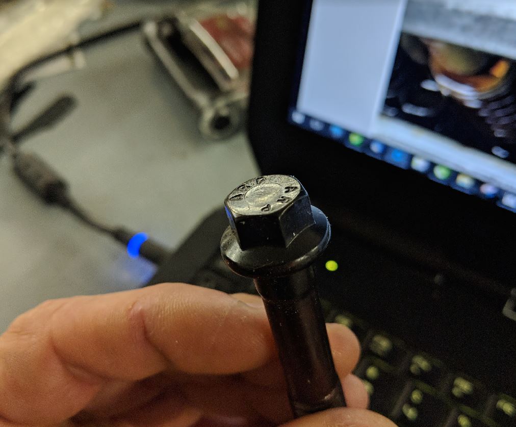

Well now with bolts I know the D series are re usable. He said that the ones in there weren’t the Honda bolts and they where stretched. I said ok well I want ARp studs for the replacement . From further investigation they look like just bolts to me. He is a friend of a good work buddy of mine so I trusted. Lesson learnt

haha yeah man, definitely not studs. not ARP bolts either from the looks of it, hope he didn't charge you for ARP studs.

He charged me $220 bucks . I told him in the begging I could go to O Riley’s in Bellingham get Arp for $180 Usd and bring them to him. He said he ordered some ughhh Been had.
