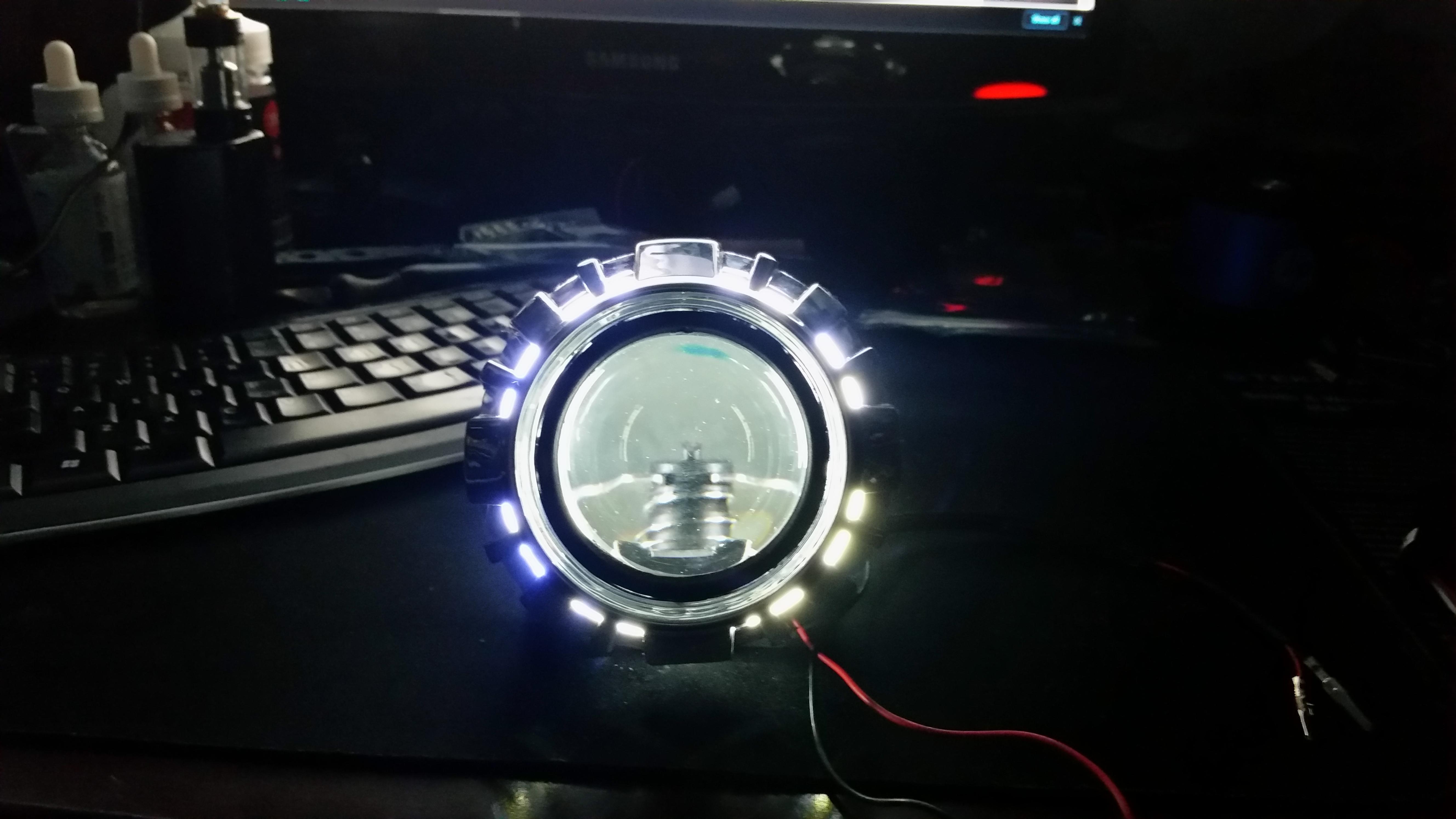

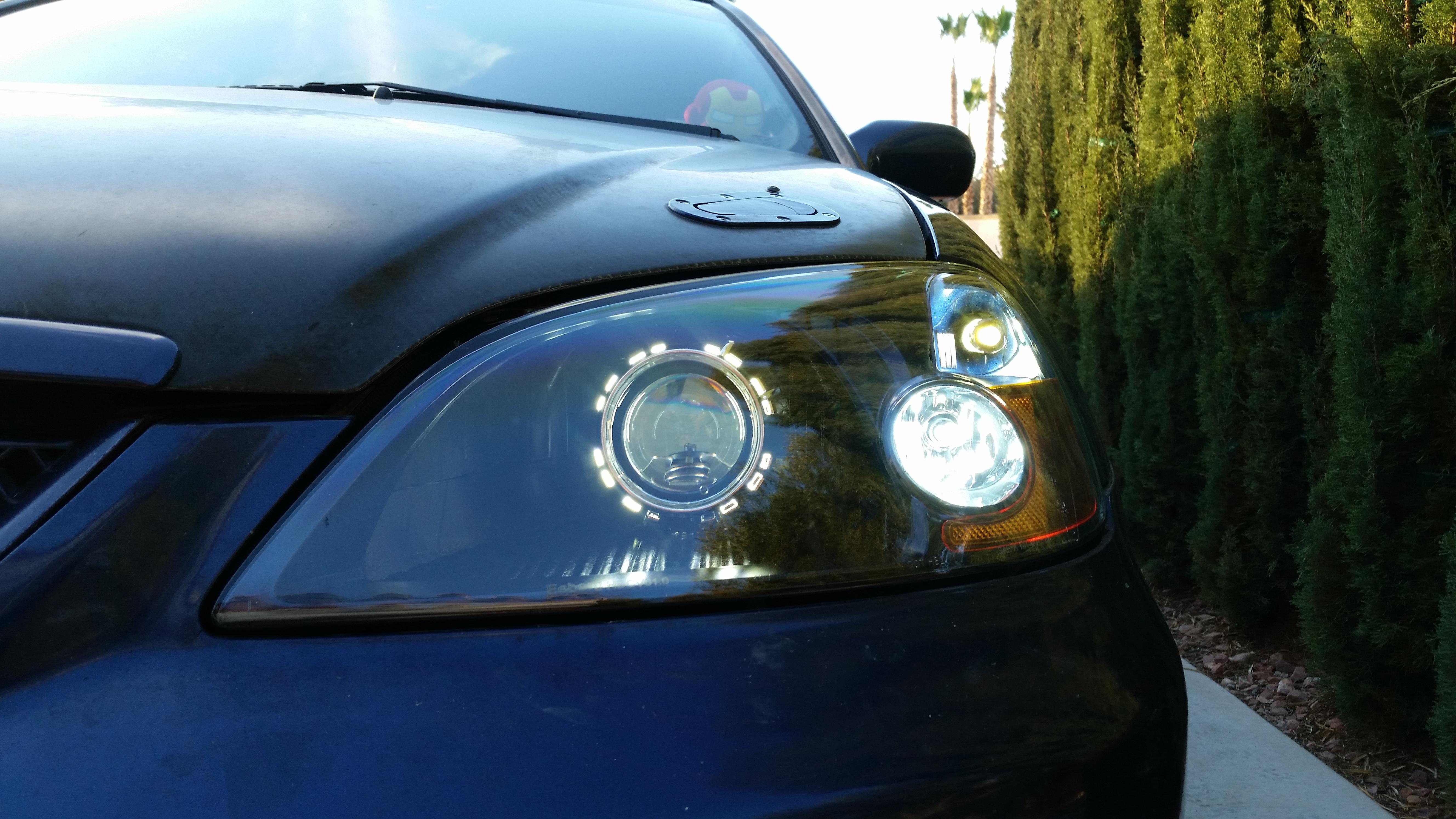

Alternatively, you can go the route I went with my morimoto retrofit on my 2002 and mount some LED halos inside the shroud. Took some creativity on my part to make them fit and work, but they looked cool as hell. Disclaimer: good luck finding those halos anymore though. Theretrofitsource sold them like.. 5 years ago..

and from when I was testing them out
