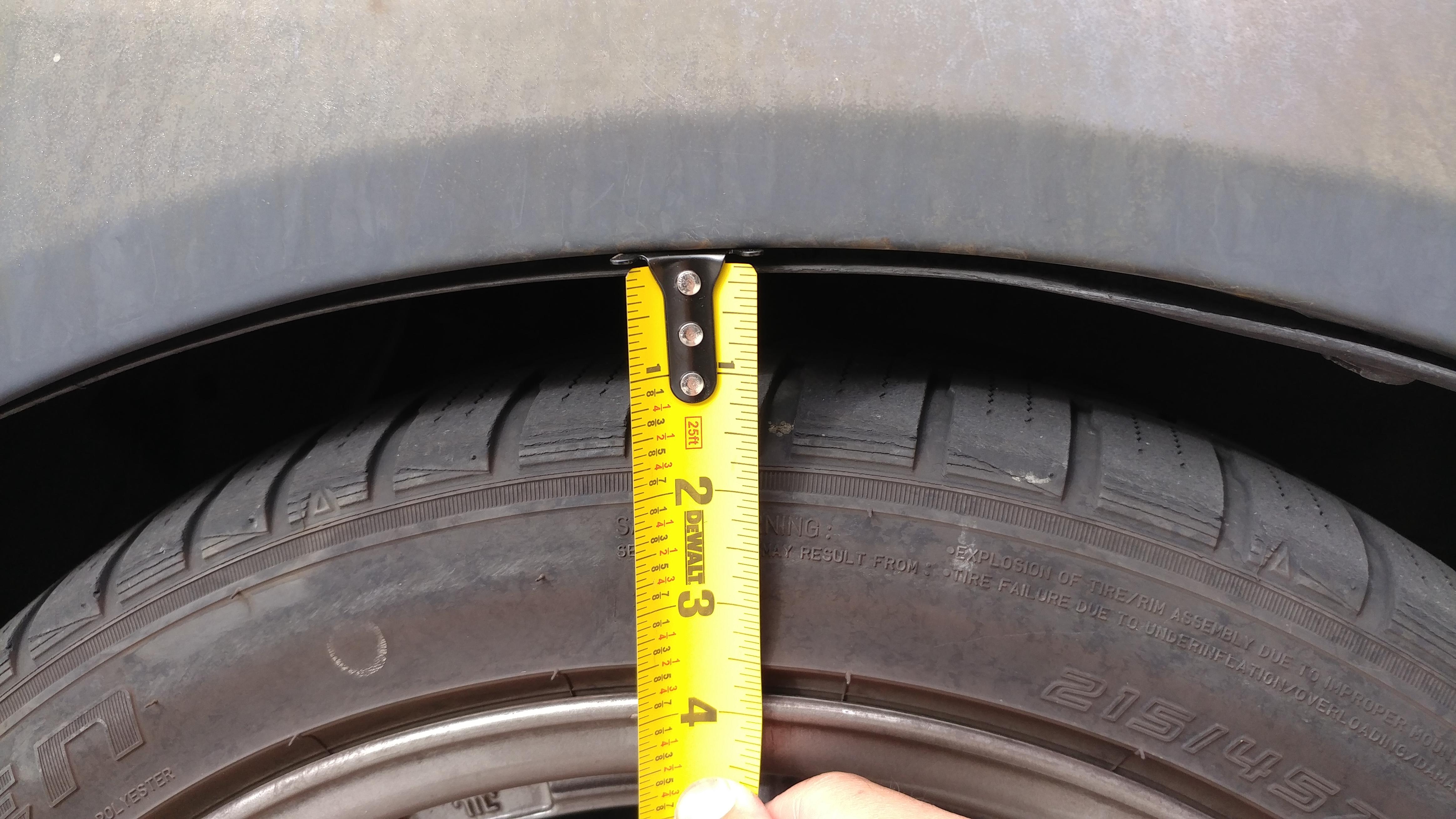

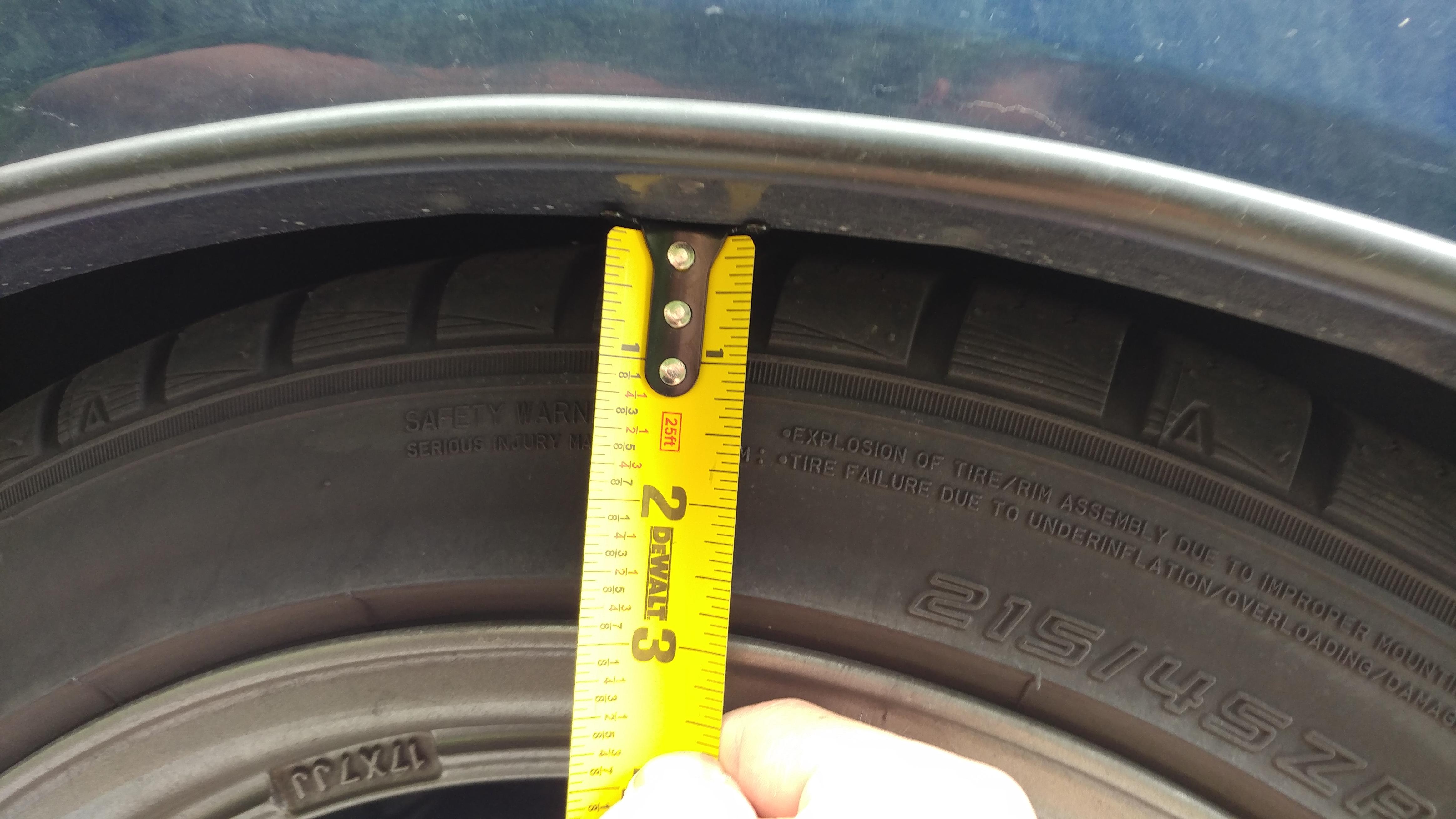

I am lowered and they damn near tuck in the rear. Thankfully, with suspension travel, the wheels' camber goes negative so it doesn't rub.
edit: took a tape measure outside and took some pics. Keep in mind my car's parked on an incline (driveway)
Front
rear
As you can see, the top of the rear tire is pretty much at fender level
