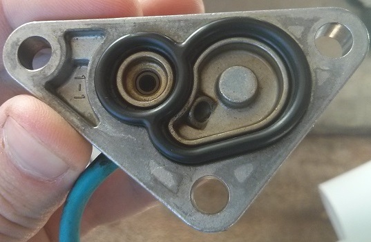

Vtec gaskets, first one is called the filter and is easily found in a parts catalog
FILTER ASSY., SPOOL VALVE
# 15825-P2M-005
Second gasket is this for the upper section of the valve (the solenoid), the only way to find it is to go back several years to about 1995 to find the part number:
GASKET, SOLENOID BASE
Part# : 36172-P08-015
