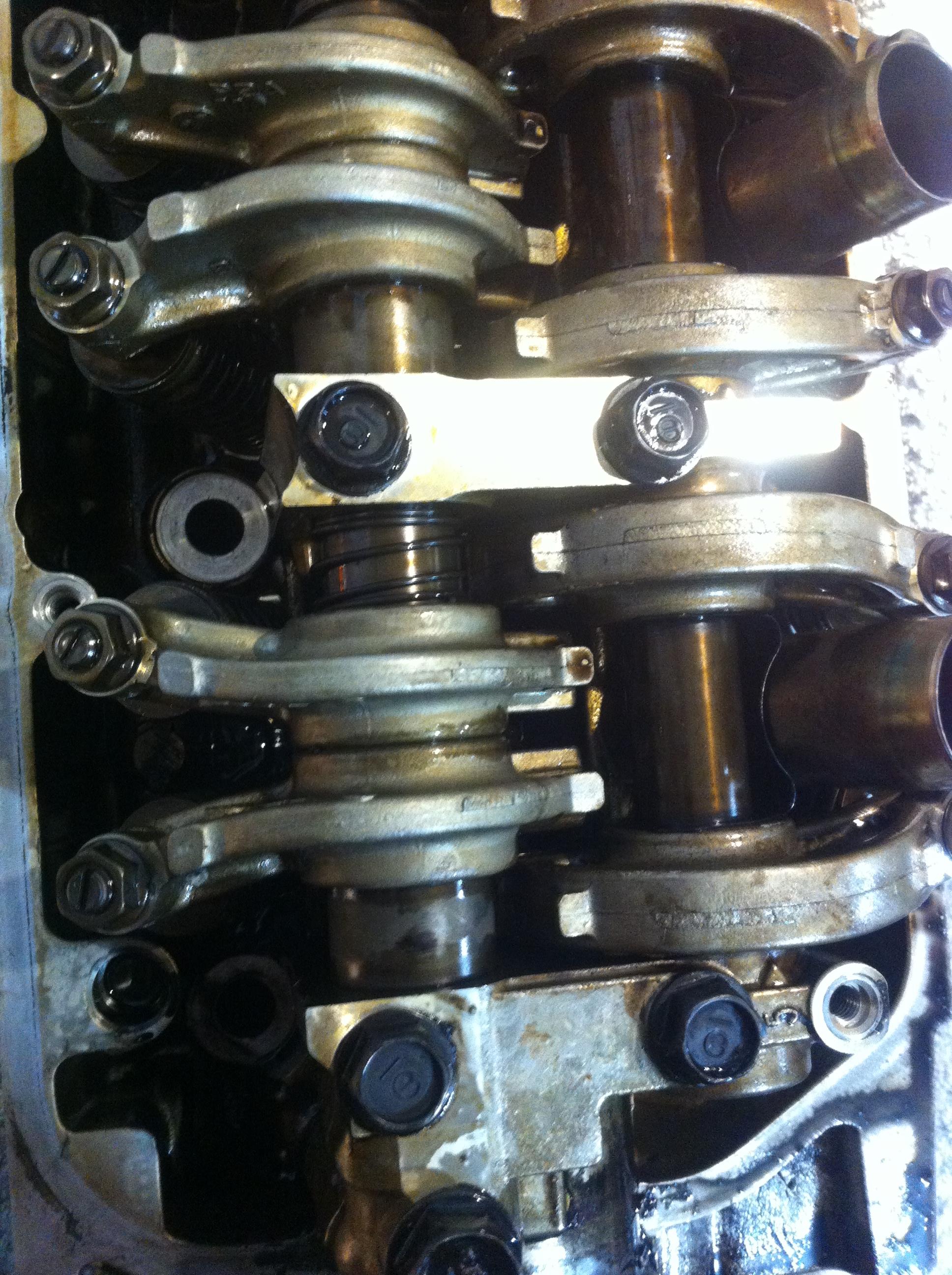

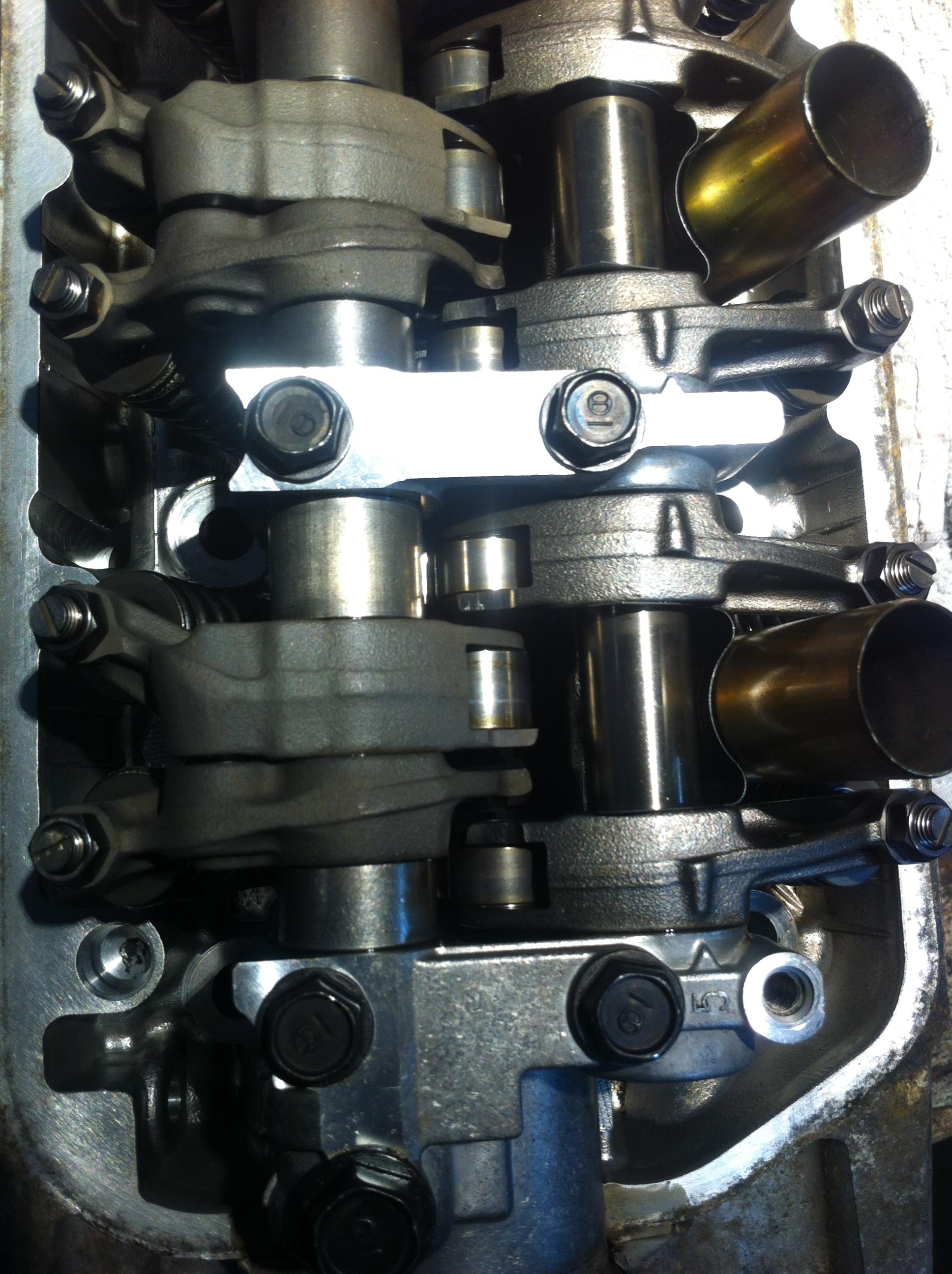

So I bought all the parts from a Honda dealer except the valves.I located a used head and sent it to a machine shop and had it checked and milled.When I get the car torn down I realize the two heads are different.
When I roll the cam over with a ratchet,on the junkyard head, only one intake valve opens fully and the other one opens just a small amount.Is this from a VTec? What is this new head from?

Old Mar 7, 2017
Re: Timing Belt Broke - How Many Bent Valves??
Ya, one head is VTEC and the other is not.
Not a match. You got the wrong head.
What year and trim level is your car?
I have a 2001 LX w/1.7 base engine.This is what the head was listed as coming off.I had never worked on one before and didn't know the difference when I picked it up.I'm bummed because I now have the car torn apart and need a different head.
I'll take my original head to a machine shop and have it gone through.
Old Mar 7, 2017
On the plus side, the valves are the same part numbers between the two head versions, so if they need to swap a pile of valves they should work ok.
Intake valve #s match, exhaust valve #s match

Old Mar 11, 2017
Posts: 15,180
Likes: 1,606
Ouch, too late here.
You can use the head, although the vtec will not work and you will have less power. Torque should be better. But you would need a controller for the vtec. So, for quick change, the correct head is easier.
The oil rings collapsing are normal. I believe mine are too...
