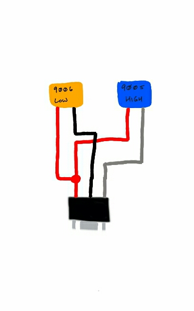

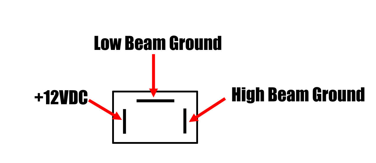

Also, as far as the headlight goes, you can make a conversion harness yourself, if you're electrically savvy. Grab a pair 9005 and 9006 female harnesses (I think they sell them at autozone) and a pair of H4 male harnesses (likely have to source online). On the 01-03 civics, the H4 bulb is ground switching (i.e. switches the ground wire source when flashing your high beam). The pic I just made below is as if you were looking at the pin side of the H4 male harness
If you wanted to convert it yourself, it's just a matter of soldering the right wires on the pigtails. If you buy pigtails, they should have enough of a wire lead that you don't need to add extra wire. Heat shrink the solder joints, wire loom for aesthetics, and dielectric grease to stave off corrosion on the (h4) pins, and you should be good. I drew up a quick and dirty (9005/9006 to H4 diagram).
One set of these and two sets of these should be all you need

sorry but i am going from 2005 and changing to 2002 system
am i reading this in reverse
Old Dec 31, 2016
Rep Power: 512
Re: 2005 front end swap
You're correct. I drew the pins on the wrong side. you need a female H4 pigtail. The wiring still works out the same on my crude little quick and dirty diagram.
