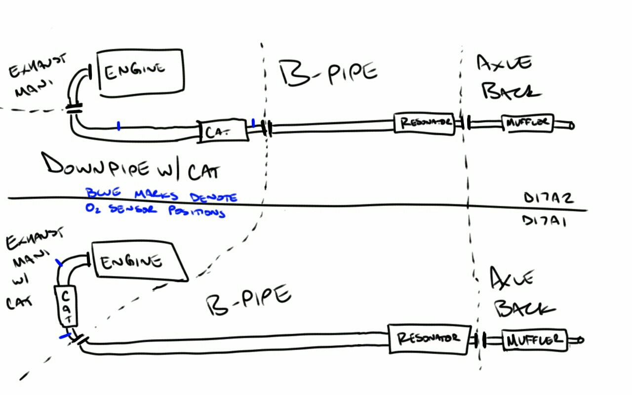

The one you linked is for a D17A1. If you wanna convert to a D17A2 (ex) exhaust setup, the only thing you'd be able to reuse would be the axle back portion. I drew this up real quick to illustrate the differences between the D17A1 (dx/lx) and D17A2 (ex) exhuasts.
edit: if you'll notice, the dx/lx exhaust manifold/cat extends further down than the ex's exhaust manifold. The ex exhaust manifold connects to a separate pipe with a cat, where as the pipe downstream of the dx/lx cat is one single piece up to the axle back. Also note the O2 sensor positions. The ex has them positioned much further back than the dx/lx, and they would have to be oriented the same (i.e. the O2 sensor upstream of the cat, if you were to do the conversion, needs to sense upstream of the cat, same goes for the sensor downstream of the cat.)

okay thank you for some reason i thought i had 2 cats but one at the manifold one on the b pipe the resonator the muffler but ill put it on the lift and double check thanks again
