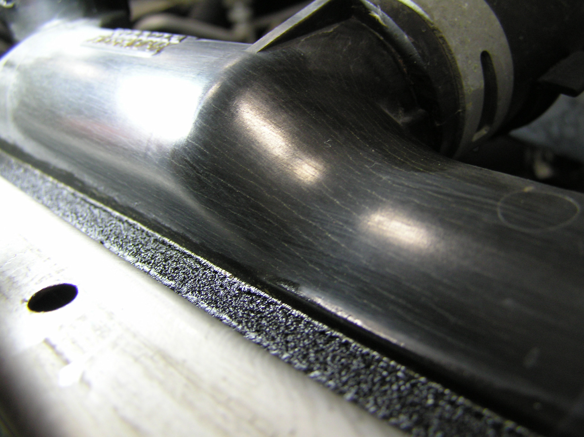

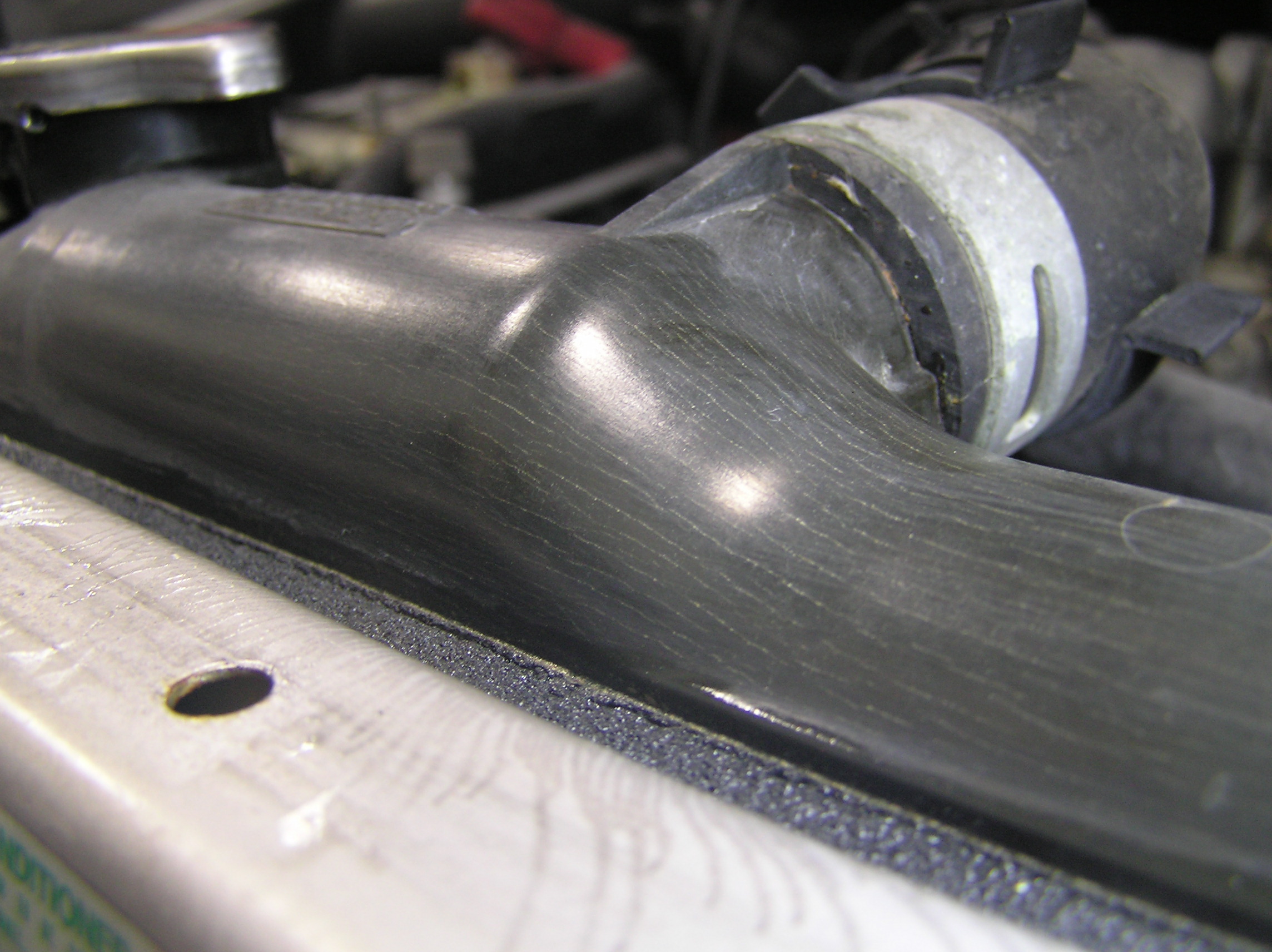

Did the radiator tank have stress lines anything like this one?
Size:  728.3 KBName:  FXYASxH.jpg
This is one I saw in an older Odyssey during a service, I noted it should be replaced and told the owner........THE VERY NEXT DAY it let go and blew coolant out of the front side of the plastic tank.
