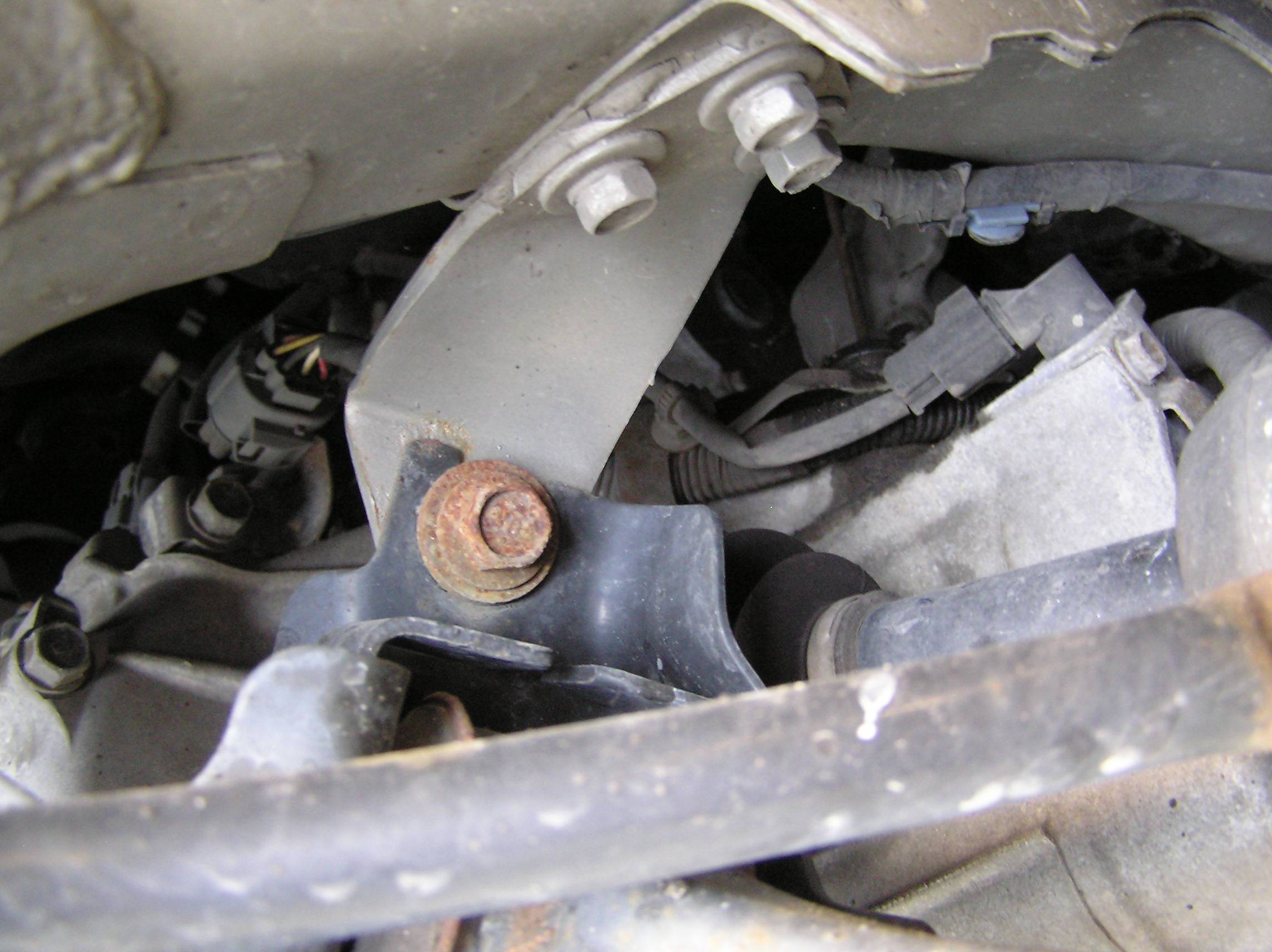

So, I got to #7 on scootys DIY, and I need to know if I'm looking at the transmission brace and the flywheel cover?

go check the other thread, try to avoid double posting
