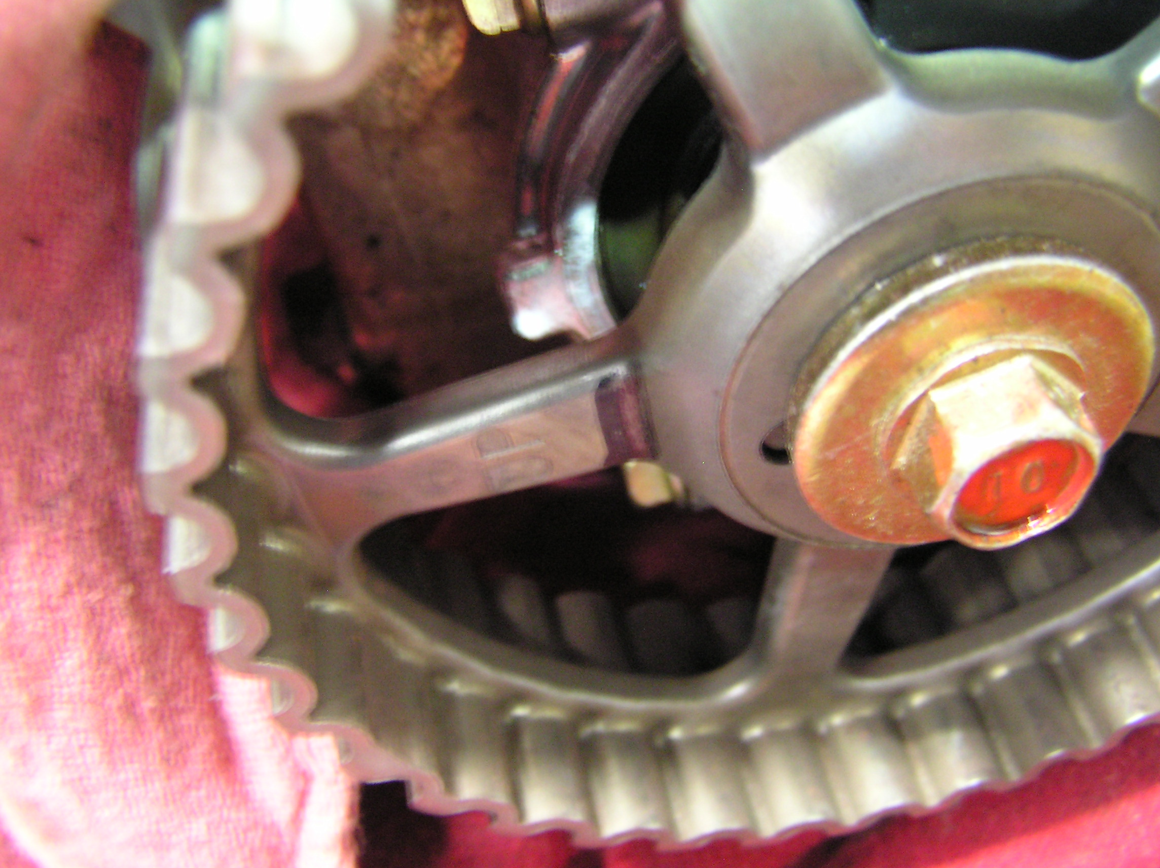

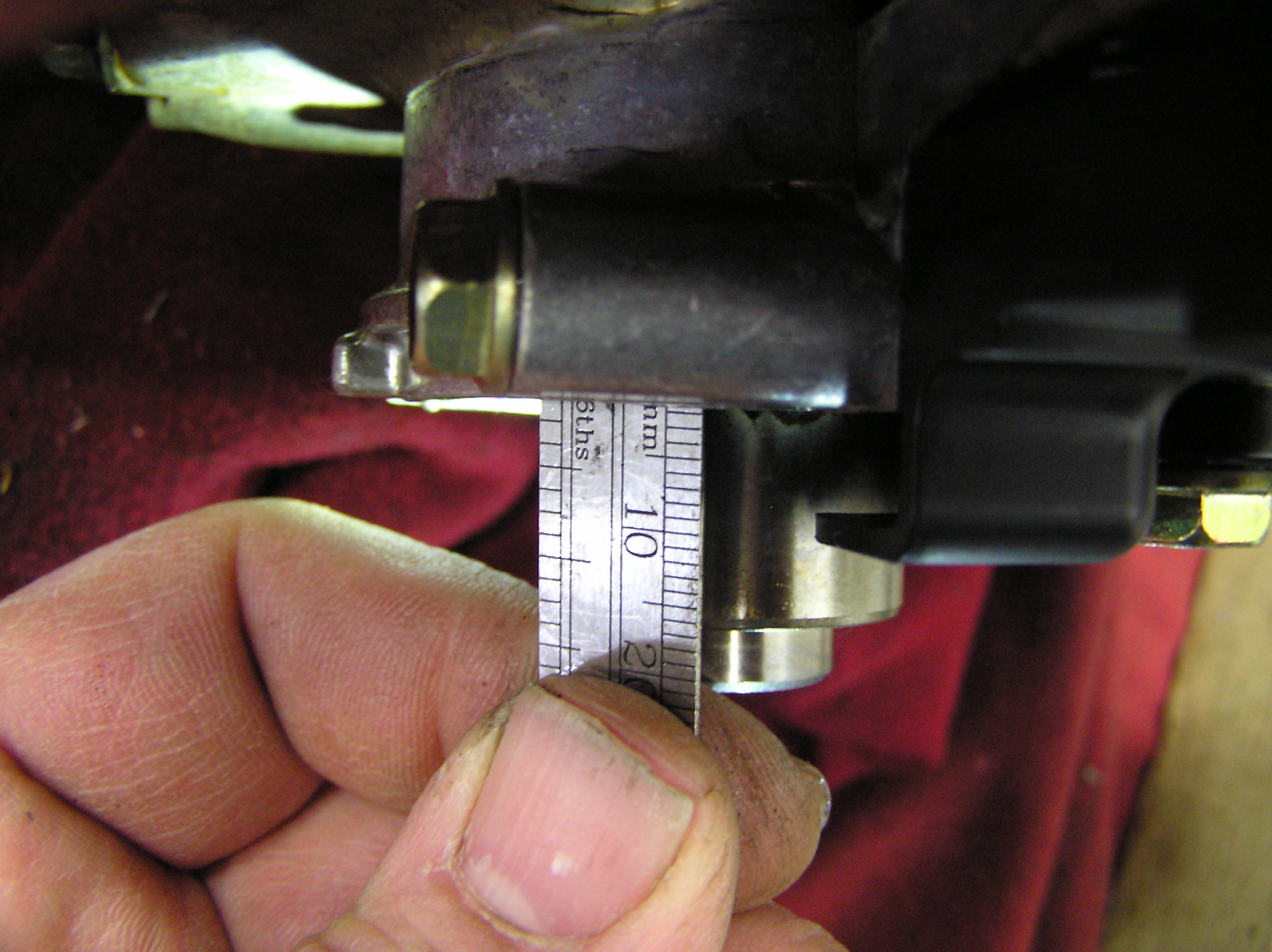

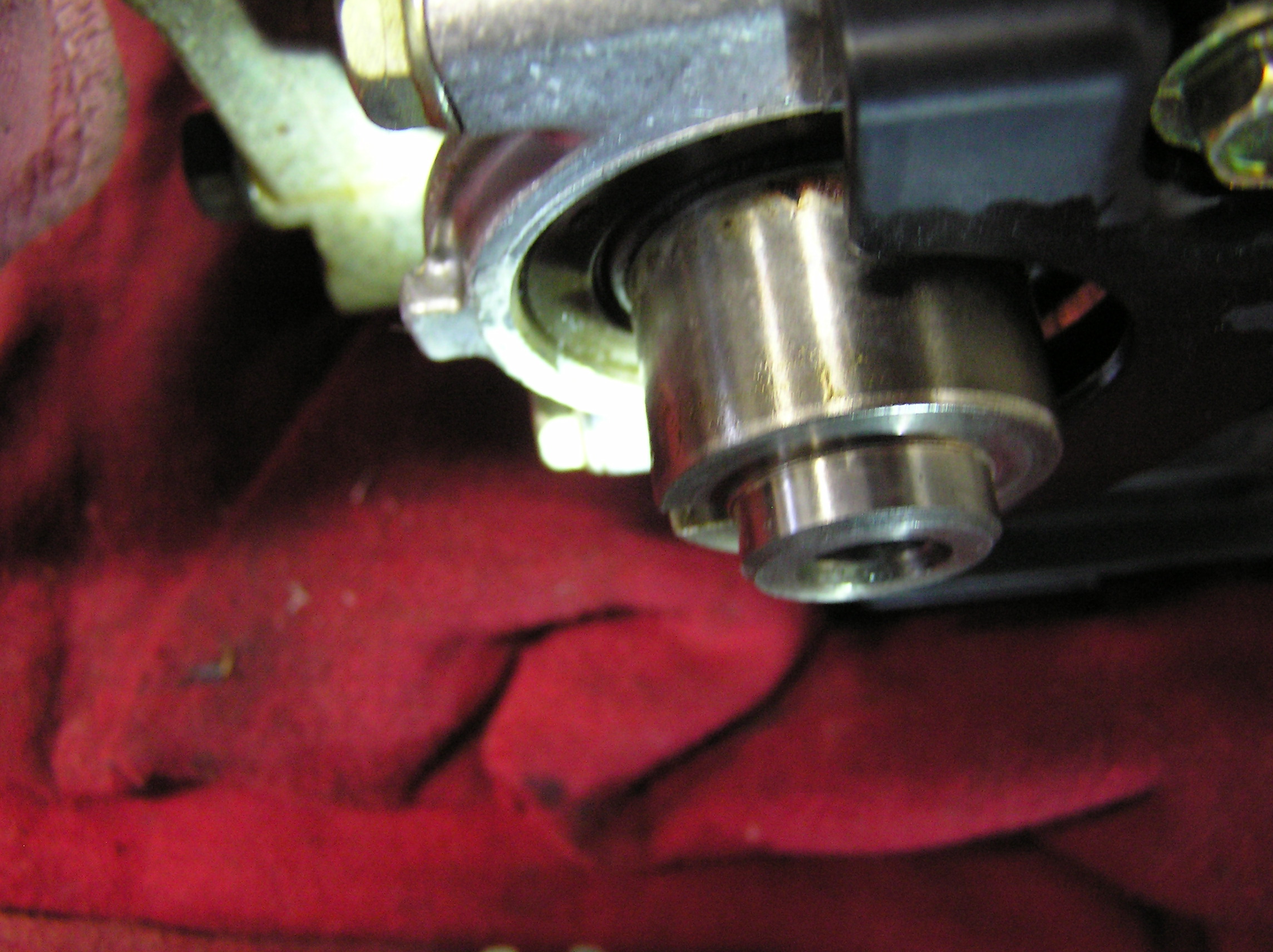

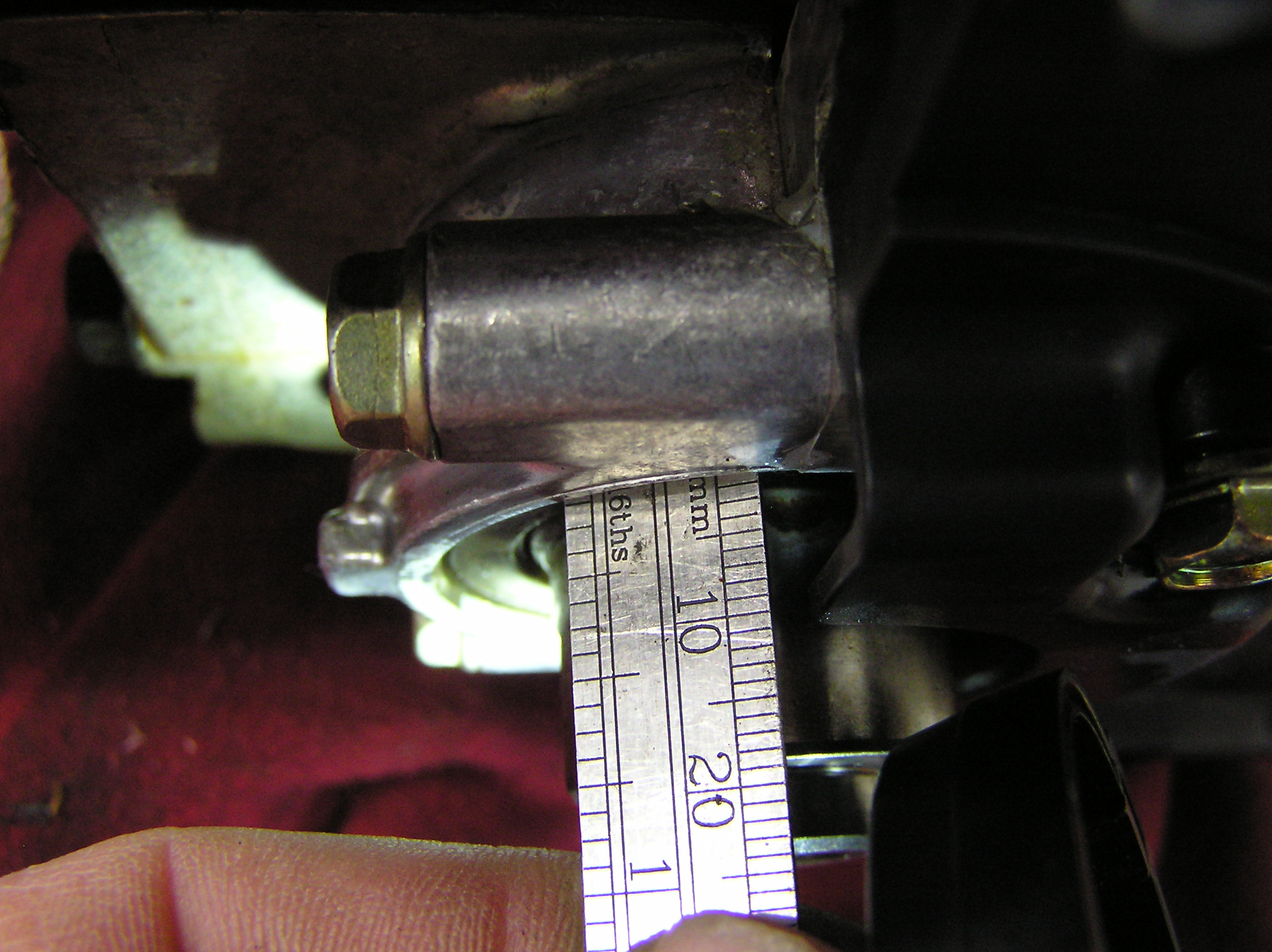

Note in the pics this original seal is installed slightly deeper than flush-- by nearly 2mm
I'll take a good look, but I don't think it needs replacing right now. Looks like I should do it with the TB off.
If it starts leaking it could cause problems. Is it as easy as removing pulley bolt, pulley and replace seal? Tap in with a big socket as a drift?
After the timing belt is out of the way, yes.

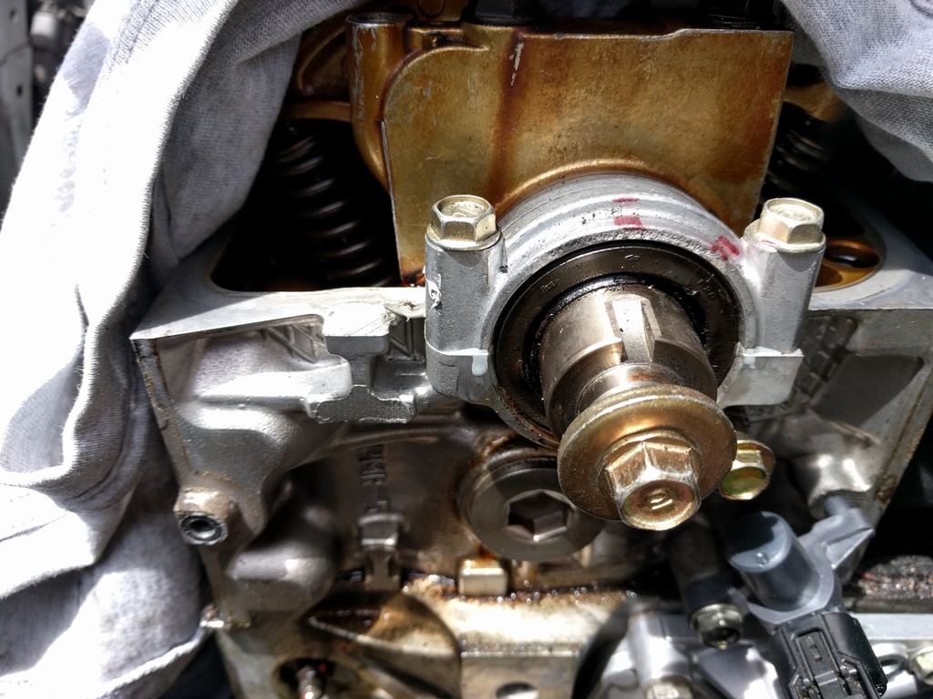

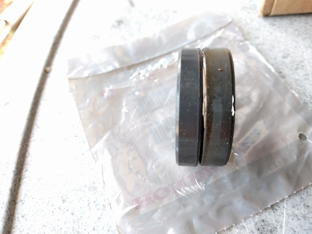

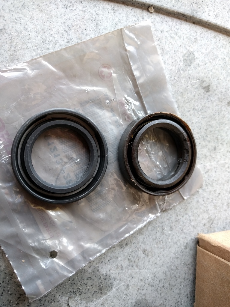

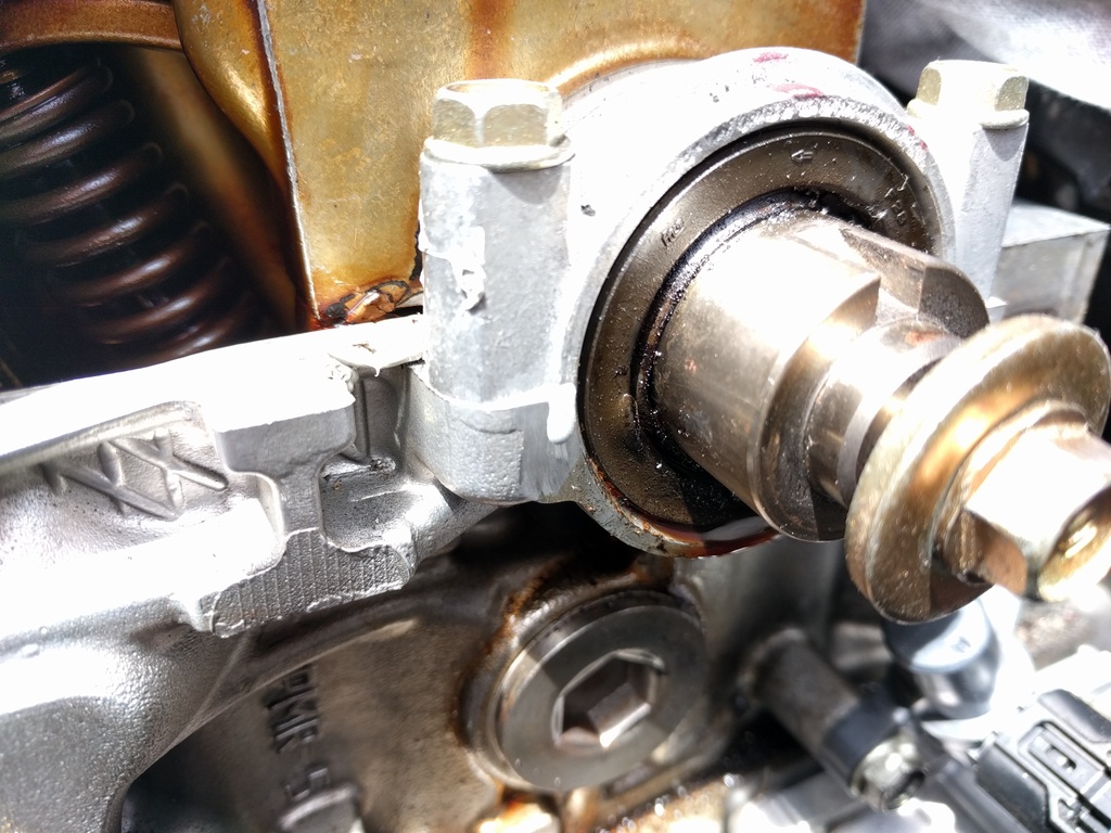

I ordered and received 91213-P2F-A01 from Majestic. Here are some pictures of the seal I removed and my new seal. I have not installed the new seal yet....
Old on the right, new on the left. The new one is thinner than the old one. So its going to be less than flush when installed. Is this a problem? Did I get the wrong part?

Is it like 2mm thinner?

Nope, its not 2mm, its a lot less.
