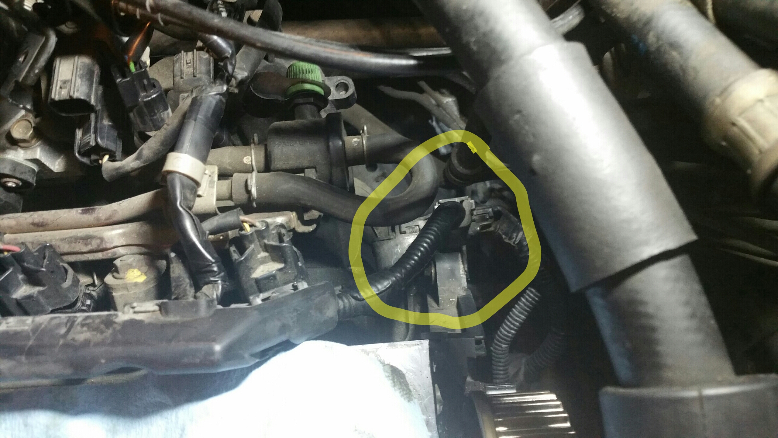

I'm not entirely sure if that's part of the fuel rail, or what it is to be entirely honest. I'm trying to get access to the head gasket. I have removed everything else I believe. Timing belt and all that good stuff, thanks to YouTube.
I cant find anything on this (not very detailed anyways). I could really use some pictures or video showing what to do, if anybody here has any.

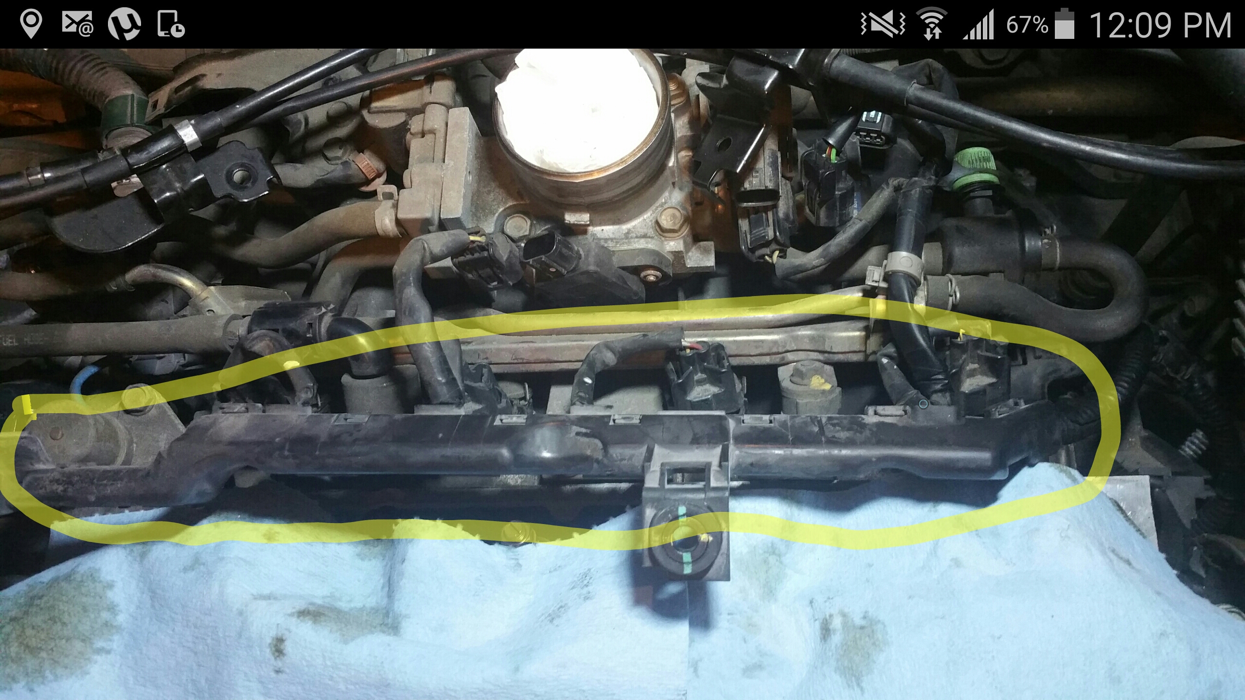

Second pic, I assume you are trying to get the wire harness freed from a little metal tab/bracket?
Go to the oxygen sensor harness connector and study how it is anchored and how it releases from its metal mounting tab, the injector harness is probably released in a very similar manner.
I don't mean how the connectors are plugged in, I mean how they are anchored.
Personally, I unbolt the manifold and leave it in the car when I pull a head off.
HTH

Yeah that's exactly what I'm trying to do.
And for the oxygen sensor harness connector? Where is that located? This is all very new to me.
I was thinking of doing the same thing leaving it attached. To do that, I have take off the brackets from underneath? Then I can pull it off in one piece?

Follow the O2 sensor wiring to where it meets the wire harness near the bellhousing, the connectors should be mounted to a metal tab
There are at least 3 fasteners you have to reach that hold the bottom of the intake to some brackets.
