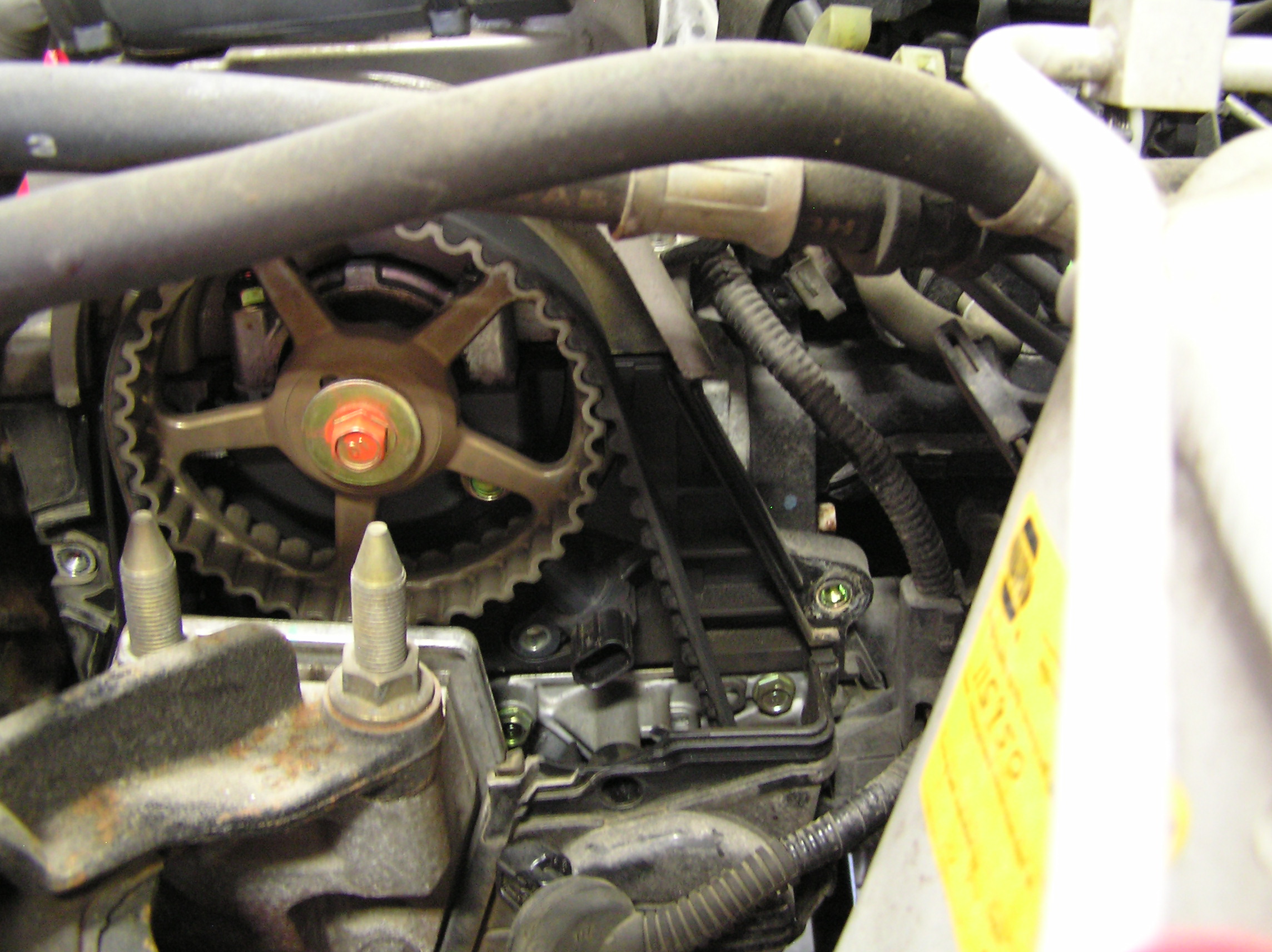

Handy pic:
Note this was a cam sensor job, the bolt is already removed from the sensor
