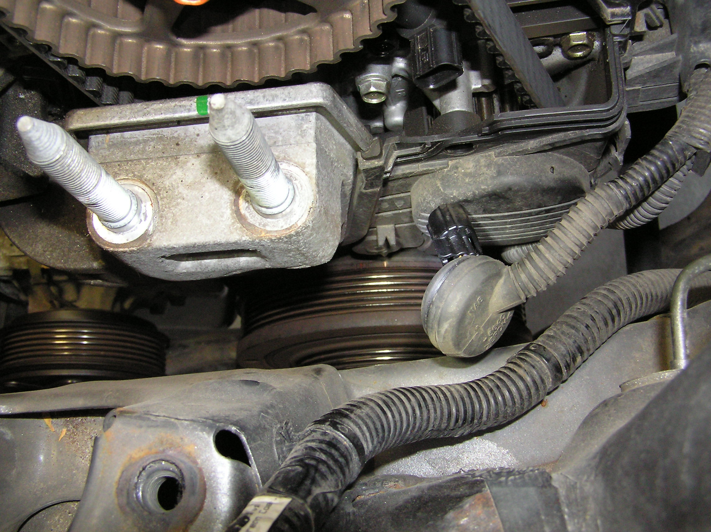

Yea cam Sensor plug in. So to check i look at the crankshaft pulley mark is point up ? Or do i have turn the pulley to mark up ? Here is a pic
I marked up with black marker
Old May 17, 2015
  #55
Re: loud noise civic 2001
I cannot tell much from your pic.
Rotate the crank pulley until UP is upward on the cam gear,
and the single ignition timing 0 degree mark (white) on the harmonic balancer is aligned with the pointers on the timing cover.
Now inspect where the marks are on the cam gear.
The slash mark on each side of the gear should be aligned with the upper horizontal surface of the cylinder head.
The parting line between head and valve cover is used in my pic here:
I use a staightedge and check alignment of both of the slash marks..... a few steel rulers are always handy in my toolboxes.
HTH
HTH
yea the ruler sure would helped a lot why didn't I think of it :-|
so do I have to take everything part again to rotate cam gear back to up by counter-clockwise rotation? balancer, I don't think my cover has that point thing I see on the pic and the white marking on the balancer did you put there or came with the balancer?
LOL
Only if it is not correctly timed.
And if you have been rotating the engine using the cam gear turning it counterclockwise, that action alone can cause it to jump time.
It should, look closely.
Factory marked it there, not me.

At one point I try keep the cam gear in place with my Ratchet and while I had my 19mm socket and extention bar and breaker bar turning it counter-clockwise trying break 19mm bolt lose(before impact wrench) didn't work to well because would tighten the cam gear bolt tighter. every time try to turn cam gear trying to turn it to set it to "up" the cam gear bolt get loose... when I finally got the 19mm bolt off with impact wrench and I redo the belt and made sure the marks were suppose to be(i wont know for sure till i get chance to recheck my work) but this time around im going get the ruler and double check everything, and I have someone coming over thurdays to guide me, he also think my timing is off. So I'm crossing my finger this is my problem not bent valve because i know i can squeeze another year or two till I can afford my civic 2009 coupe si... this civic 2001 has serve me well for 3 years now I got it for 2300 had 230k when got it now is 240k on it and 4 owners so has been through alot hands...
you are lucky you didn't strip the cam bolt threads right out of the cam!
doing this could also damage (or strip) the teeth off the timing belt.....i wouldnt even use that belt anymore, i would replace it

before work
the ruler say im tdc
but crankshaft different story you view from different angle looks like you are tdc but if you view it directly down looks off
i took two pic
