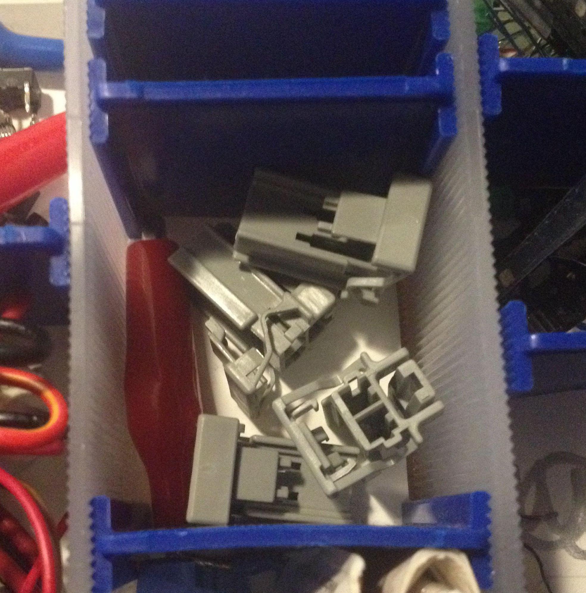

I, uh, might have a few of those turn signal pigtail terminals laying around..
edit: I think these are them
PM sent.
