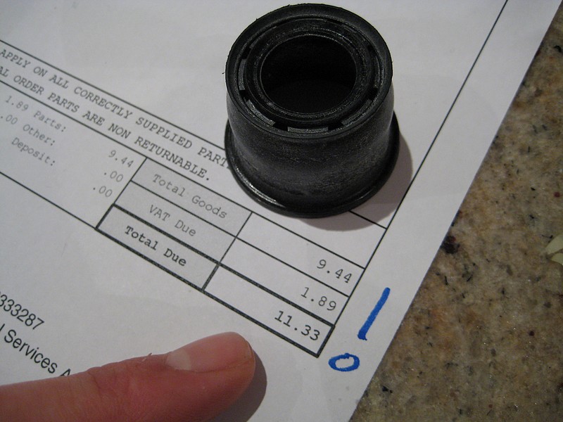

Yep, 3 door, 1.4 hatchback. From what I can tell comparing the manuals I have, the UK car is basically the same as the US Gen 7 Civic (the major difference, of course, being that I just spent 11.33GBP / 18.13 USD on a little rubber boot at the stealership today!!)
I've sprayed a little plusgas on the droplink threads just in case I can't pry the wishbone down enough (hopefully change the boot on the weekend).
I do still need to find something roughly the right size to drive the new boot into place. Come to think of it, how hard is it to pull out the old boot, if the new one has to be driven in? What do you do, split it with a stanley blade?
