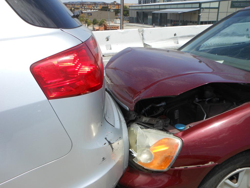

Someone hit me on the freeway and pushed me into the SUV in front, so it had both front and back damage and they totaled it, gave me $4,400.
