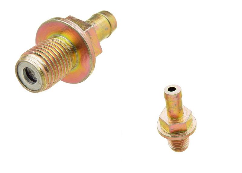

Maybe it has already been said but have you checked this and the line to it to make sure it is open. The pvc valve should rattle. Clean with carb cleaner spray. OEM is probably better then an aftermarket replacement.
Name:	PVC 2002 Civic.jpg
Ripsaw,
What is that? Would you explain me a little. I feel kinda lost.

Originally Posted by Pablo2312
Ripsaw,
When the pistons drive down, some compression and gasses leak past the rings. Even, just driving down, the air needs to go somewhere. The PVC (positive ventilation control) usually in the valve cover but on some Hondas located in a box on the side of the block run to the intake where the fuel is drawn into the engine. This is the part shown for your engine on the inportec.com web site. If it were to get stopped up, the pressure could be causing oil to be force into your intake. Usually on these cars, if oil is changed regularly, it never becomes a problem. Just a guess on my part. I do not have a service manual on your engine. Also have not a clue of your maintenance or how you drive. I have had three of these car and never had a problem but I have never had the throttle to the floor ever. Loaned one to my son and he broke the big pulley off the cam shaft in one night. So they will break if flogged hard. Sounds probably like your rings are worn out if you drive card hard and hit the red line a lot.
That was the PCV valve.

I'd worry about the oil viscosity long before I'd worry about the PCV valve. But if it hasn't been replaced since you've owned the car, it's a good time to swap it out, as it's quite easy to do and inexpensive.
