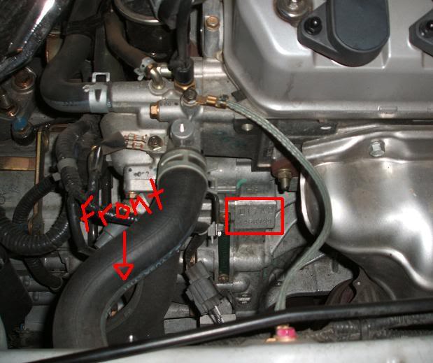

Automatic, and to be honest im not sure the engine type. Im pretty sure its a d17a_ something... sorry for the lack of knowledge.
Old Jun 11, 2014
Re: 7th gen transmissions
Old Jun 11, 2014
reapertgr's Avatar
Joined: Jun 2014
Posts: 10
reapertgr is an unknown quantity at this point
D17a1
