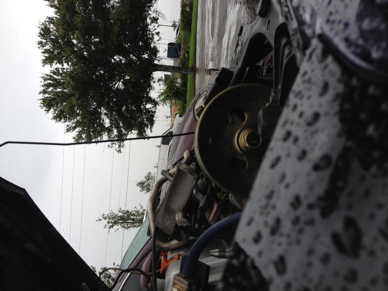

Ok ppl this is what it looks like

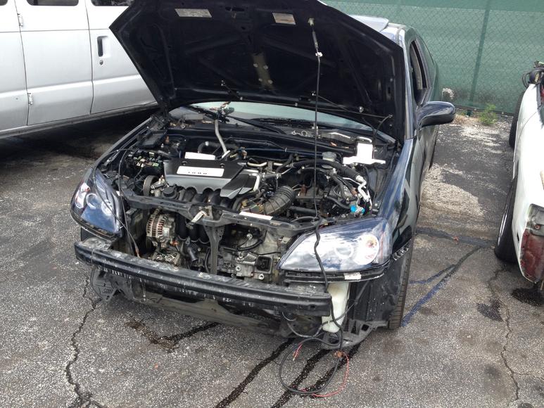

Here's more

Re: kswap into a em2
Hmmmmmmmmmmm. K20Z3?
Most people swap in a K20A2. You will likely run into more compatibility issues with this engine but it should be fairly similar. What are you going to run for ECU?
I'd cut the hood to be honest.. How far out are you?
Here read this and see what it says about the power steering pulley. He had to cut his too.
http://www.7thgenhonda.com/forum/showthread.php?t=26327

maybe an 1-1 1/2'' sticking up, im taking my time with this swap it only has 18,000 miles jdm. ecu is the issue which 1 will work for my car, theres lots of them out there, if you can plz provide me with a model or model #'s..thanks blue
