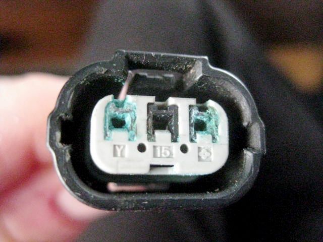

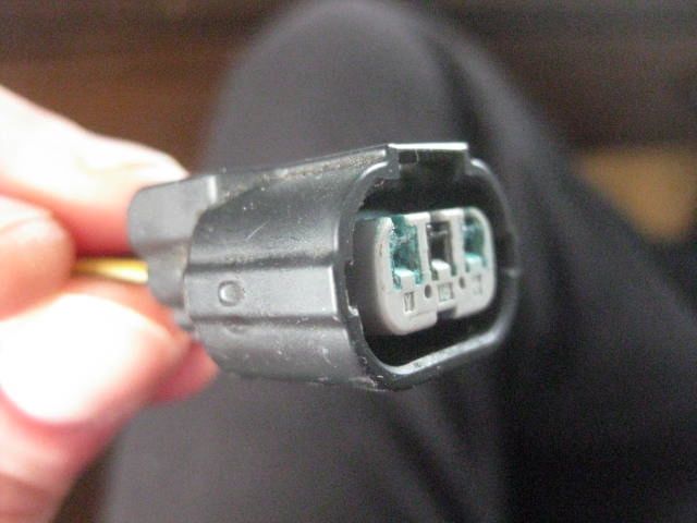

I had the same problem:
My car stalled while driving down the highway. Would crank, but wouldn't start. Towed it to shady service center. They found the #6 F1 ECU fuse kept blowing, but couldn't figure out why. They talked about the fuel pump etc - had no clue. So I did a search and ended up here! After reading some people had problems with their Crank Shaft Sensor, I unplugged that and voila! The fuse didn't blow any more and the engine would run! I got the hell out of there since they didn't know crap and limped my car home. Took it back to the dealer that had replaced the Crank Shaft Sensor 11 months earlier (a month after they changed my timing belt and water pump, the Crank Shaft Sensor died... coincidence??) and they found corrosion in the plug and replaced it for free.
My experience is that you can drive the car with the Crank Shaft Sensor unplugged, but it will "buck" a bit when under load going up hills or trying to accelerate hard. I've driven it twice now that way - once to drive it to the dealer, once to drive it home from shady repair shop and then to dealer.
From reading other posts and doing some research, it seems very common to have problems with the Crank Shaft Sensor after replacing Timing Belt and Water Pump. Anyone else have this problem?
Long story short:
dealer replaced timing belt and water pump.
1 month later, Crank Shaft Sensor went bad.
Dealer replaced that on my dime since they wouldn't admit a connection.
11 months later, car stalled and wouldn't start (#6 fuse F1 ECU kept blowing)
Ended up being corroded Crank Shaft Sensor plug.
Dealer spliced in new plug and replaced Sensor for free... good to go!

Old Feb 17, 2015
Re: Engine won't turn over - FI ECU fuse blowing
Attachment 87521
Attachment 87522
Thanks for the pics.
There CAN be issues with liquid entering that connector even without disturbing the connection.
It is a 'known' problem area (to some of us that deal with the cars very regularly).
When I do a timing belt job on this engine I do not unplug that connector. I always unbolt the sensor and move the entire unit out of the way, wires and all.
Your pics indicate some sort of liquid got inside the connection and corroded the terminals over a period of time. This corrosion typically results in an intermittent code or no signal code.
You said it was blowing fuses...seems to me that would be an internally shorted sensor problem.
While this wire corrosion pictured doesn't normally cause fuses to blow.....
The corrosion COULD have got inside the sensor body and into the circuitry to cause it to become a short circuit.
This is all speculation on my part.
At least they covered the repair under a warranty, so that's good.
