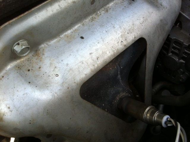

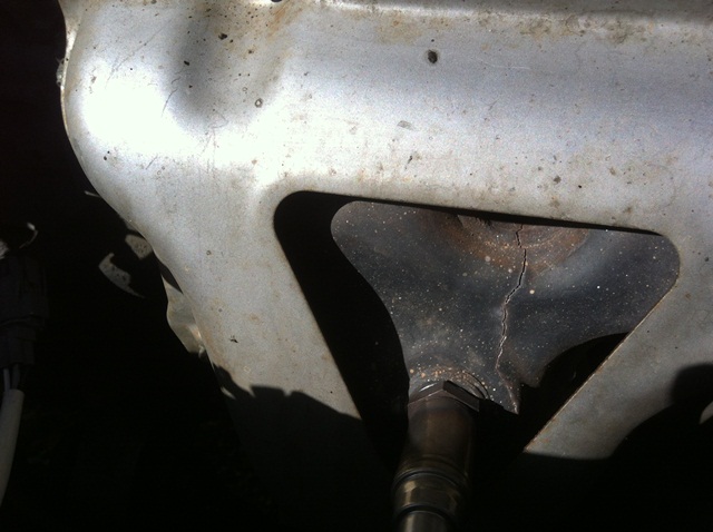

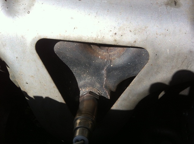

Thanks for the replies. I looked closer when the engine was cool and discovered the crack runs around the back as well. The manifold will have to come off. I just hope it doesn't come off in two pieces.

Some pics. I ran my finger under the heat shield at the top and could feel the crack on the back side also.
