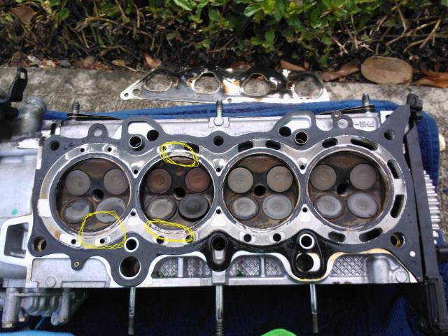

Re: New 2005 Civic Owner here! Stop in and school me a little!
Sorry but I don't agree with that. I was just talking with someone that had ridiculous mileage/years on an original head gasket. I believe if you drive these cars to manufacturer spec and do routine maintenance very little will ever go wrong with them. Thing is most people don't want to drive between 2-3k RPM, lol. So if that's you then stock up on head gaskets, I guess.
BTW, what is "manufacturer spec"? Are you saying people never drive over 3k RPM in these for anything whatsoever in the entire life of the vehicle?
BTW, my HG blew at 10 years and 86k miles on it and I routinely revved it above 3K on an almost a daily basis. What's your opinion on that?

@the Op, everyone that's supplied info is pretty well versed in the issues that these vehicles experience, especially ezone who is a dealer tech.
The head gasket coating around the fire ring tends to where away over time, probably due to excess heat and allows cylinder pressure to enter the coolant system and pressurize it. There's almost a zero chance of the break occurring between the coolant passages and the oil drain or pressure holes in the head. That's why your oil is not milky. You have an MLS head gasket. Very solid with the exception of the issues around the fire ring.
Below is a picture of my head gasket when I replaced it on my vehicle. You can see where the coating has worn away around the fire ring. I just circled a few of the areas that were worn away. It never over heated. It spewed coolant out the reserve tank. ezone was kind enough to help me through the replacement process.

Oh yeah, I just read through this thread again and yeah your head gasket is shot. I mean get it tested but yeah, it's shot. The overfilled reservoir is a huge indicator.
