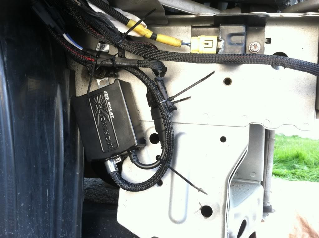

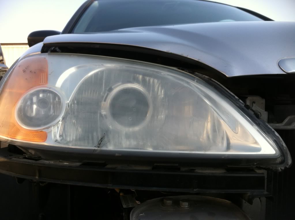

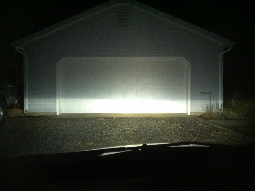

^ all great advice. I just did my retrofit this weekend and it was a direct plug and play with no cutting needed. I was able to aim them properly with the stock adjusting screws. I ended going with Morimoto ballests and relay harness cause I didn't want to take a chance with a cheaper kit. If you want a better cutoff line then I would suggest painting the stock reflector housing a darker color. My cut line line isn't as crisp as I want it to be but it's still good. Here are some pics:

Cutoff Line.

Old Dec 3, 2012
sl33pyriceboi's Avatar
Posts: 9,196
From: SoCal 714/909/626
Rep Power: 353
Re: 02 Civic H.I.D. Headlights tips, questions, and help...
^you needa buff out and clean your headlights man. that haze/oxidation is taking a good 20% from your output.
Old Dec 3, 2012
GolNat's Avatar
Prelude Owner
Joined: Sep 2011
Posts: 6,202
Likes: 358
From: DE
Rep Power: 245
Yea that was going to be my project this weekend. I didn't realize how bad it was until i took the picture :-/ It is pretty bad.
Old Dec 4, 2012
lowlife9's Avatar
Joined: Feb 2009
Posts: 4,315
From: connecticut
Rep Power: 257
that glare is probably from all that haze on your lenses.
