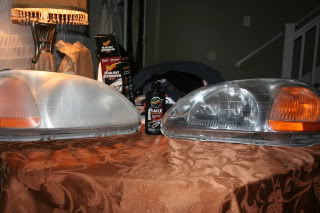

I had my old headlights laying around they were hazed up like hell and I came across this thread. Best 5 Bucks I've ever spent, Low and behold the before and after! Gonna JDM these bitches up!

WOW what a difference!

Yeah I bought the Meguiars Plastic-x Kit, comes with a buffer pad for my drill, eff doing that crap by hand man!

Holy crap... it looks like you were driving through St Elmo's fire or something.
What a difference though. I think I'm gonna polish up my headlights tonight.
