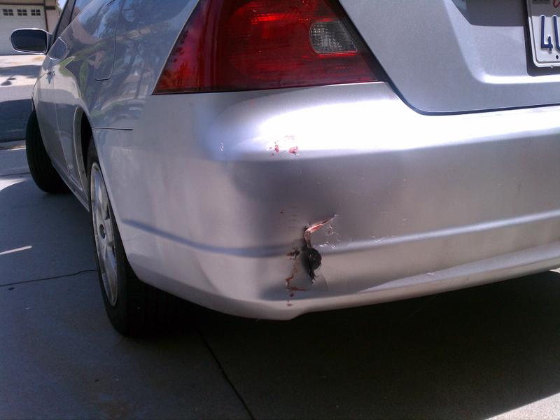

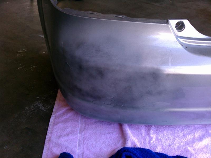

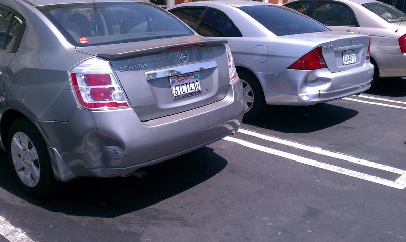

So for the last few months, I've been riding with my rear bumper like this
Anyways, yesterday, I was sitting in my car in a parking lot and this guy who works at a body shop offered me to fix the dent and crack that it had along with another dent from a golf ball right over my rear right tire.
He torched the bumper and popped out the dent, put some fiberglass? material over the crack, sanded, and then put primer on it. He didn't have my paint so he told me that was my job. All that for a $140 which is not bad compared to paying about $600 at a shop.
He told me that before painting it, I should wet sand it and what not.

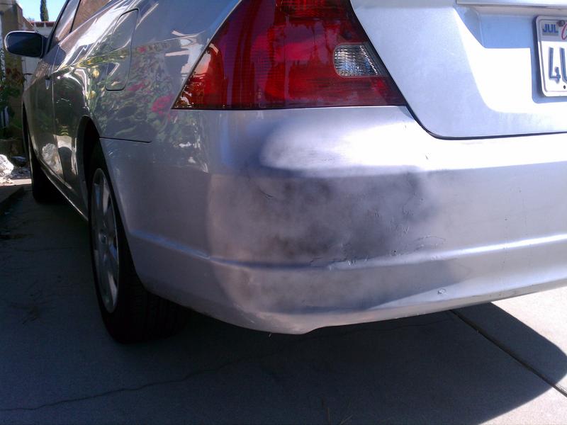

Here's how they look like now. (I still need to paint it.)
The last two pictures are the results after he popped the dent, fiberglassed, sanded, and primered.
For those who have knowledge with paint, do I just need to wet sand it and paint it? He didn't mention clear coat or anything which I thought was a part of car painting. And do I need more than one coat of paint? I know I can't make the car look flawless, but I still want to take the right steps.
Re: painting bumper questions
For $140 sounds like you got majorly ripped off. Yeah a shop may charge $500 to install a painted bumper but you get a finished flawless looking product for that price. You could have done what he did yourself for less than $20. Oh, and the reason he didn't finish it is because he KNEW it would look terrible and you wouldn't pay him. Slick bastard.
The way he left that bumper is no where near ready to be painted. If you do attempt it to paint it, it's going to look like crap and you'll wish you spent $140 more and got one of those bumpers from EBAY already paint matched and delivered to your door.
Honestly I would just buy a new bumper. You're looking at at least $40 in primer, paint, sand paper, polishing compound, buffer and wax to get it done semi-respectable looking. And yes it needs to be clear coated.
As for the rear quarter, not sure what it looked like before he touched it but I'm pretty sure it looks worse now. Looks like he just used bondo in the dent and primered it over. Dents have to pushed or pulled out, not filled in with filler because it falls out eventually. That whole rear quarter is going to have to be painted and clear coated now. If the dent was small with no paint damage then it could have been knocked back out from behind. Now that there is bondo and primer all over your original paint it's going to cost quite a bit to repair it.

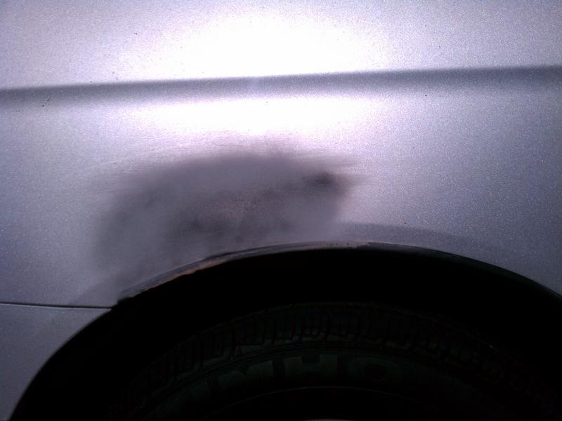

As for the rear quarter, it's actually a very small portion . I guess the picture made it look huge. I was thinking of taping off the surrounding area exposing only the affected area and working from there. The dent is gone, he pulled it out.

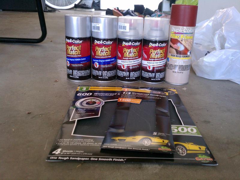

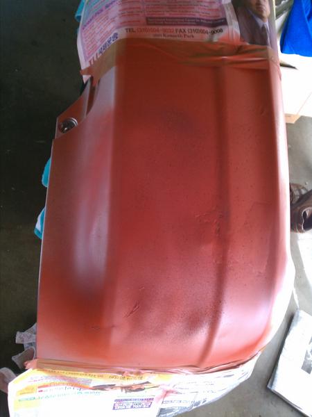

So I purchased the supplies I needed.
Two cans of Satin Silver Metallic, Two cans of clear-coat, a can of filler primer, some 600 grit sandpaper, and 1500 grit.
I know it looks dirty but this is after I washed with dishwasher soap and warm water and rubbing alcohol. I used a good amount of alcohol because I wasn't sure if it was clean or not.
Then I took some 600 grit paper and started sanding the affected area. 600 was way tot fine to get any of the excess bondo off. (I realized what a poor job this bastard did on my bumper). So I took some 320 grit I had to try to get some off. Worked a little bit, then went back to 600 to smoothen it out.
I applied two coats of primer waiting 15 minutes between the coats.
Scooty, I know you told me to wait four days for the primer to dry. but time is a bit limited for me bc I do a lot of driving so I might consider painting on Thursday.
The bumper is sitting in the garage with good ventilation and it's always warm and dry in there so that's good news. That's it for now.

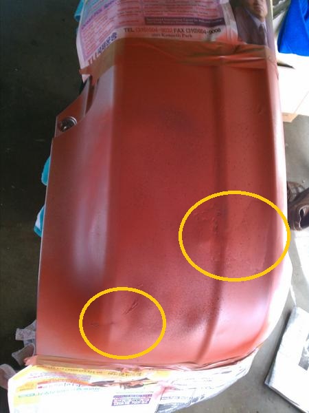

Yeah I noticed his crappy work right away, but you got the supplies and motivation on your side!
Looks good so far. The circled areas are going to be problematic for paint adhesion. You need to get those flat and smooth. Hit them with 100 grit. It looks like he used an epoxy based compound so it's going to be hard to sand over it, but the 100 grit should cut through eventually. 100 grit leaves deep gouges so go over the area with 2 or 3 grades of progressively finer grit until you get to 600, say 250 then 400.
Also when you are ready for color and have removed the masking tape and news papers, feather those tape edge lines in with 600-1000 grit or else you will see very noticeable edge lines in your finish.

I started painting today.
But before I started, I used some heavy grit on the circled spots Scooty pointed out and re-primed it because the primer flaked off. Then when I started wet sanding the whole primered area, it would flake a little bit here and there. Just a few small places.
I applied a bit more primer on those spots in case and let it fan dry for an hour.
Then I sanded it with 1500 grit and got ready for paint.
The first coat was light. The primer was still visible. Waited 10 minutes. Second coat covered most of the primer but a hint of red was still visible. Then my last coat covered up all the red and overlapped some good paint (btw, I made sure I feathered out the sanding on some of the good paint). The paint suprisingly matched up with the surround area pretty well except for the lack of glossiness. All in all, it looks pretty decent except there are some blotches of filler that show from the guy's work. Even 60 grit paper couldn't get it off. But it's hard to see unless you're up close.
One mistake I made while I was painting was spraying too close. For the most part, I kept my distance but there is one spot where I slightly drenched it and the drips are showing. Any way I can get that crap off when the paint dries? I was thinking of using fine sandpaper.
Pictures will be up tomorrow. Couldn't get good shots bc i painted during sundown.

Well, you're paying 300 for a good paint job.
All my equipment I used to partially do my bumper was a little bit under $50.
I guess if you have the confidence to do it right yourself, go for it but I would leave it up to the pros.

As you can see, waiting for the paint to dry is key over here. Three coats of paint can easily take a month to completely harden. The more coats you have the longer it takes. Once you spray clear do not do anything else for at least 3 weeks, not even a car wash.
As for your paint runs, all the more reason to not spray clear within 24 hours, as that will just lock all the imperfections in. At this point you need to use 1000 grit to smooth the runs out. Might even have to go down to 600 grit. Then respray with color, after washing and cleaning of course.
So you see you will be introducing water and sand paper to your fresh paint. Not ideal, but like I said it's a compromise. The longer you wait for the paint to harden the better. I would not do anything else to it for at least a week to 10 days.
Now, if you were in a paint booth with a professional compressed air paint gun and quality paints, the color would have gone on smooth with no imperfections and you would be able to spray clear within 24 hours for max adhesion.

Just an update on my car.
So I had the clear coat done a few days ago.
Everything looked great. I fixed the drips, the paint matched surprisingly well. I was just gonna wait two weeks or so for the rubbing compound and then, I crack my bumper hitting my house wall while backing into the driveway. It was a <4mph impact and the filler stuff came off and the cracked part was exposed.

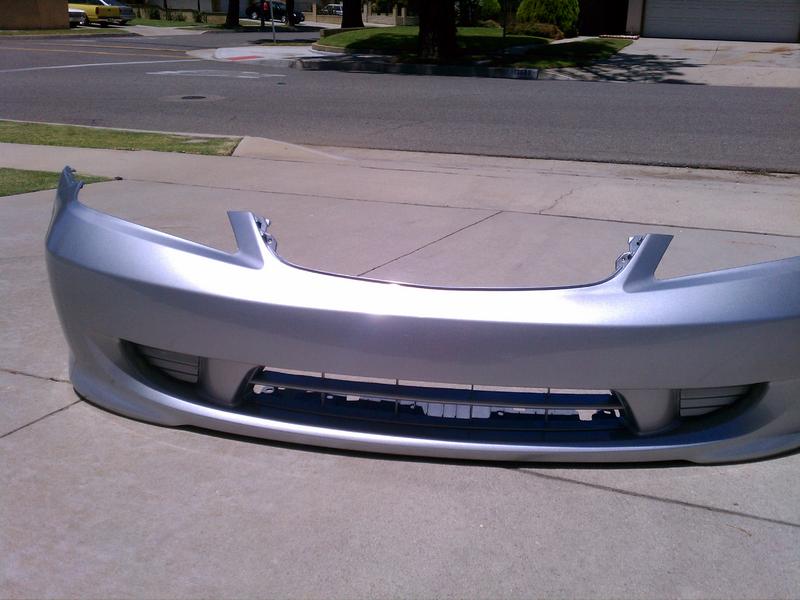

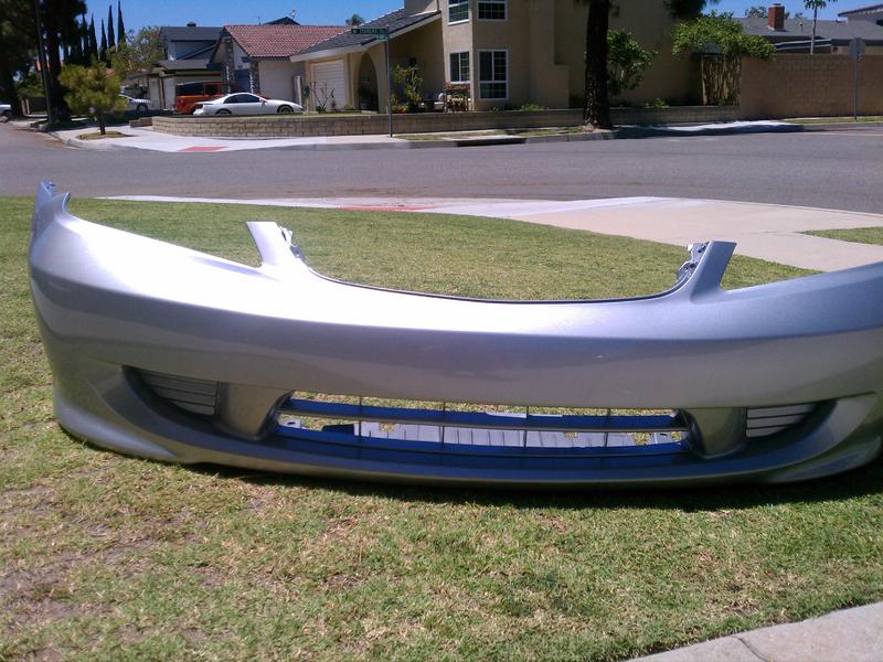

Thanks, it seems to look even better now that the paint had some time to cure.
So today was the day my REAR bumper was supposed to come but they gave me a front 04-05 bumper instead for who knows why. Like how the hell do you get that mixed up? Do they not double check the order before starting the work?
My online receipt says 04-05 Honda Civic REAR bumper. It was even in caps for Christ's sake.
Sorry I know I'm ranting. I waited 9 days just to receive the wrong one.
Not gonna lie though, it looks nice and their paint quality is pretty good actually. Looking at their ebay vendor reviews, they seem pretty legit. D&H autoparts if anyone ever needs a replacement body part for cheap with paint.
Their customer service sucks though. They keep telling me to contact their "error" department via email because no one is there to answer the phone. And as I expected I got no reply via email. So I'll give them a call tomorrow and demand some service.
