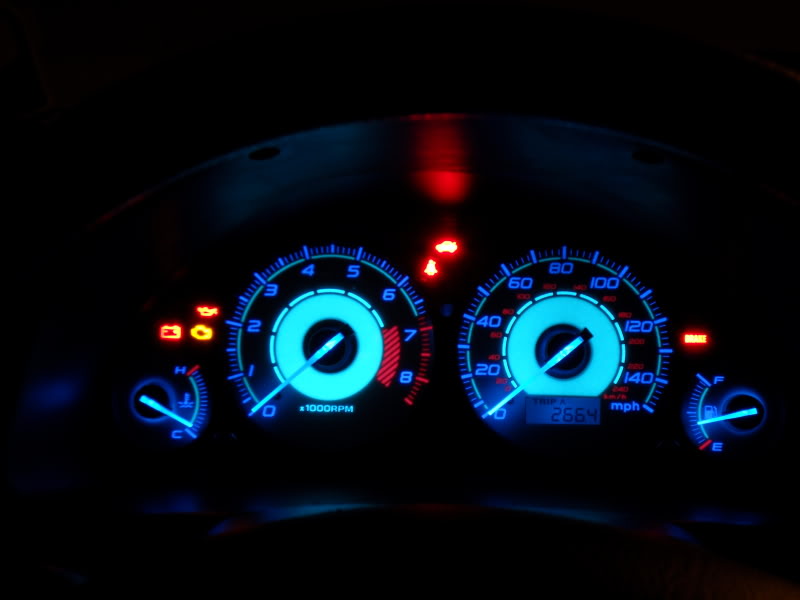

there are also a bunch of different kinds of overlays on ebay. Here's what mine looks like all lit up.

those gauges are gorgeous! and yea what you have is exactly what i am looking for. i hadn't realized they are just overlays instead of just being an entire unit. i kind of do need an entire unit though because there is a crak straight through the glass of mines. or is it possible to replace just the glass? also thanks for the tip
Thanks for the compliment. Mine is just an overlay I found on eBay for $20 back in 2004.. The simple ones like mine are a bit harder to come by nowadays. I was super picky about finding this one, too. A lot of eBay overlays had cheapo brand logos all over em, and I finally managed to find one without. Also, my needles are custom. I took em off the cluster, used rubbing alcohol to get the orange off, and painted the backsides of the needles white so the blue light from my home made LED instrument cluster bulbs would "travel" down the needle. In the daytime, they're white, but still visible.

As far as the needles, well, that was a DIY job, and quite frankly, quite a pain in the *** to do
Edit: those gauge face overlays are hella hard to find these days. If you want your cluster to look like mine, better hop on it before it goes away

Ok man thank you so much. Is this something you use to replace the old clusters with or is it a layover? And man..those needles tho lol what did you use to do it? Also, did you have to replace any lights? I legit want it to look exactly like yours.

The eBay link is an overlay. Same deal as what I got.
Needles: pulled them off the cluster, used cotton ***** and rubbing alcohol to take off the orange, and used a white paint marker on the back of the needle.
Lighting: this was the tricky part. I basically made custom LED bulbs using the sockets as a base. I had to take the cluster pretty much all the way apart so the LEDs pressed up against the clear plastic diffuser. That way, I got the most efficiency out of the LEDs, since LED light dissipates quite differently than incandescent.
Reinstallation of the needles was an über pain. I had to put em back on with the engine running. I have another tach output signal, so i used that to ensure my tach was accurate. Fuel, I just had to remember which mark it was on prior to removing them. Engine temp, i just waited for the car to heat up and put it just below half. Speed.. lol.. i did this in the not safest manner. I drove it and found the minimum speed at which my cruise control would engage. Then I put the needle on pointing at 25. Its pretty damn accurate, especially considering my calibration methods.

You have to tap the overlay's power apply into something. Seriously just find a +12 DC line that's hot when your parking liguts are on and ground out the negative, and you should be good.
My odometer light is another custom LED bulb, since every other bulb I tried wasn't bright enough for my liking.
