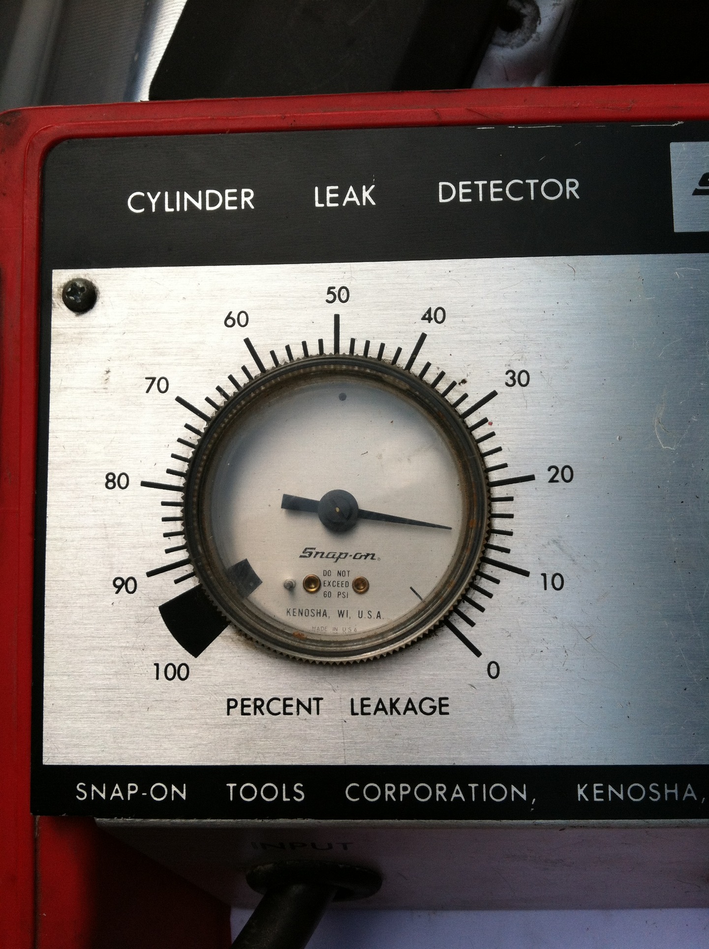

Anyways I ran the test twice on all the cylinder just to make sure..
Here's the result:
Cylinder #1,#2, and #3 has 18% leakage.. pretty much all looks like this

I have a 2005 Civic EX with 161,000 Miles, blew the head gasket twice. Never done anything to the bottom. I did the test hot/warm, right after a nice drive. I used a Snap-On MT324 Tester. I have heard that this is very sensitive compare to other testers.
Is 18% an OK result for an engine with 161,000 miles? Need info yo!
I have read that below 20%, you shouldn't worry about it too much.. but at above 30%, that's when you have major problem and time to rebuilt.
Old Jun 18, 2012
Re: Leak Down Test Result
Did you do a compression test that led you to do a leakdown test?
What were the results of the compression test?
Or is there a specific problem that led you to use this test?

Old Jun 18, 2012
Ok, I never pull out a leakdown tester without prompting by a lousy compression test. I gotta have a reason.
A decent tight engine should give 10% or less after the rings are broke in.
An engine with Total Seal%u00AE "gapless" piston rings could give 3% or less. (Not even sure if those exist anymore, LOL)
The miles you have, I'd SWAG that less than 20% is probably fair, but could be better.... I'd say to do the compression test though, see if they are fairly even.
HTH

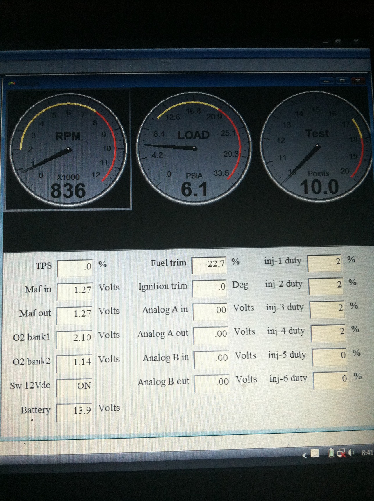

Here's an idea..
If the Map Voltage @ idle is high, how do i fix this?

I don't know why I took a picture. I could have use Print Screen. Haha.
Old Jun 19, 2012
Whut tha hell is that?
That causes more questions than answers for me.
You got a kinda generic set of data parameters, and only a few are usable.
There is no MAF on a stock engine,
Is that really the MAP instead?
The O2 values are off the chart like this was taken on a cold engine. Is "Bank 2" supposed to be the rear sensor? There is no bank 2 on a stock engine.
The "fuel trim"...far too negative. Is that LTFT or STFT?
The cam alone, I really don't know anything about. Is it a dual lift deal with stock profile for the low end?
I wonder what the data would look like with a stock cam.
A bunch of overlap would kill vacuum and cause rich codes with a stock PCM. Actually, almost any deviation from stock could affect how the stock PCM thinks.
Old Jun 19, 2012
bryan.0831's Avatar
Joined: Aug 2011
Posts: 159
Likes: 18
From: North Jersey - Bergen County, NJ
bryan.0831 is an unknown quantity at this point
LOL. Sorry. I just Plugged in the AEM FI/C for a minute to see what's going on. I don't really use it I keep it unplugged. I just wanted to see the voltages but I never really run with it, just saving it for future use.
And yea, I just started the engine and ran it for a few minutes. Sorry again.
The fuel trim is calibrated because I changed the injectors to a Type-S. So STFT.
I should've never posted that. LOL
Old Jun 19, 2012
I guess you have to ignore the rich code then, or get it all dialed in good once it is all set up.
Fat injectors and a cam should cause richness that the computer don't like. I can see it, anyway.
Old Jun 19, 2012
