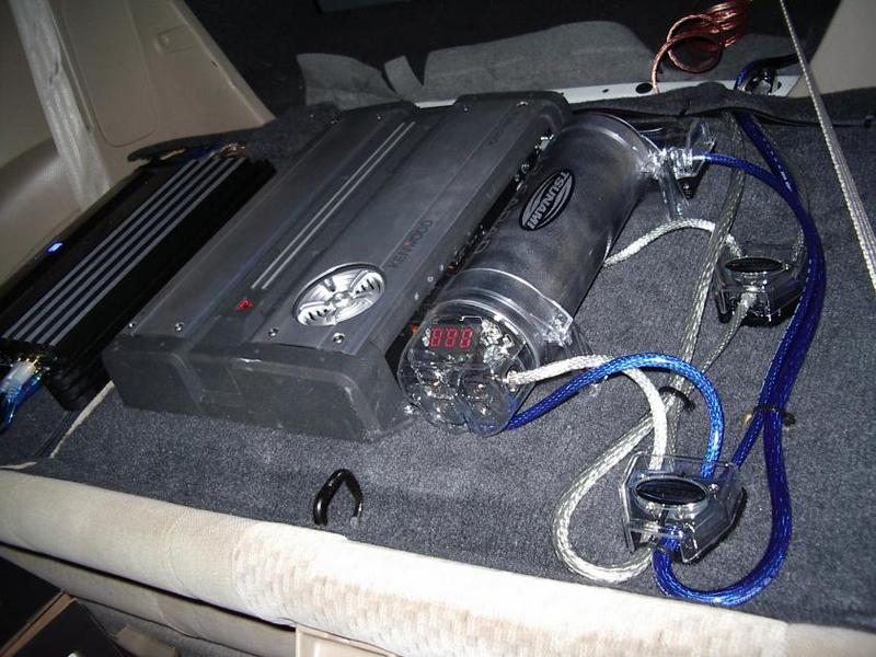

Im still running my 4 JL audio speakers off my deck amp, connected from speaker right to the deck. Sub to my amp.
Always wondered what would be the benefit if i were to add a second 4ch amp and run my speakers to that instead of the deck. Some say it would make it louder, which mine already is. Some say it would sound a lot better from the speakers, which mine already sound great. Scary to even think it could sound better and im technically not hearing the best out of my speakers. But i want to keep my setup clean and not add too many more wires, plus it would be more strain on the alternator. Even though i have a semi high output one.

ive got a million wires running to my trunk it just depends on how you mount everything. i even have all four of my crossovers for my mids and highs running to the trunk.
