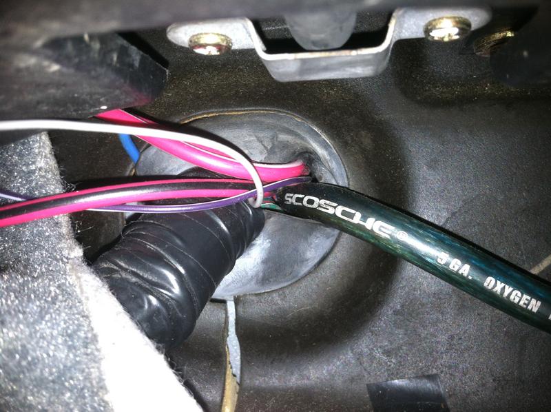

Originally Posted by GolNat
I had to zip tie mine to the back seat because there are bars...I cut through the main wire harness grommet that is on the firewall. Use an Xacto to push through the grommet (CAREFULLY) If I remember correctly its on the passenger side. It should be the only one has lots of wires to go to the ECU.
So I just push through where the wires are already and they'll end up in the engine bay? Sorry if that sounds dumb I'm just not sure lol. I saw in some other threads some people went through the grommets in the door panel, how's that sound?
Old May 12, 2012
  #37
GolNat's Avatar
Prelude Owner
Joined: Sep 2011
Posts: 6,202
Likes: 358
From: DE
Rep Power: 245
Re: this amp okay? maybe a better one?
Yep, the grommet is big, here are some pics of the firewall grommet and where I put my wires.

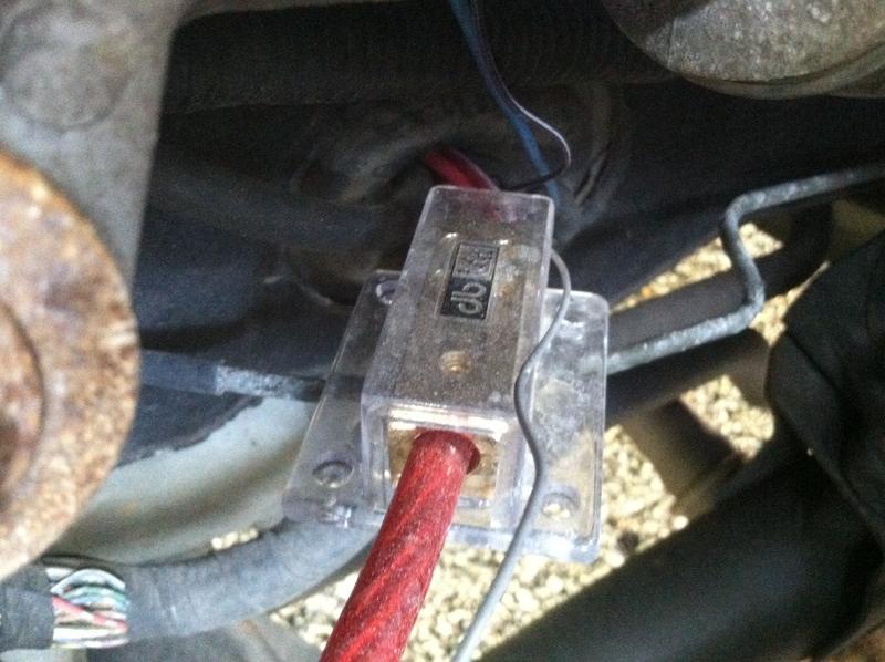

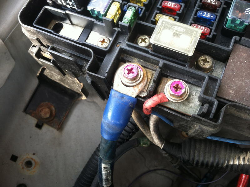

Awesome! Just wondering, but why do you have your fuse capacitor for the positive in the engine bay? Why not splice it before the grommet?
That's not a fuse it's a junction block for my remote start. The fuse is suppose to be about a foot or less from the battery.

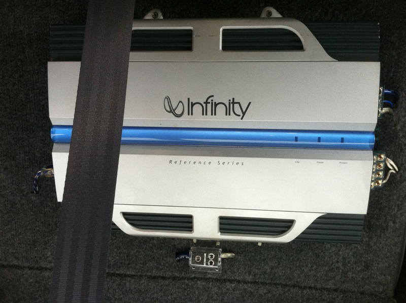

i have plywood screwed into the braces on the backseat pulled the carpet back then mounted the amps.i didn't want to be ghetto and just zip tie everything its a more solid mount.and make sure you have your low pass filters on and then mess with the gain to get it where you want it.

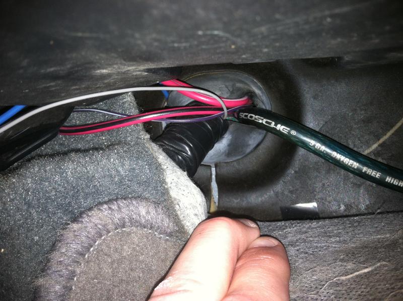

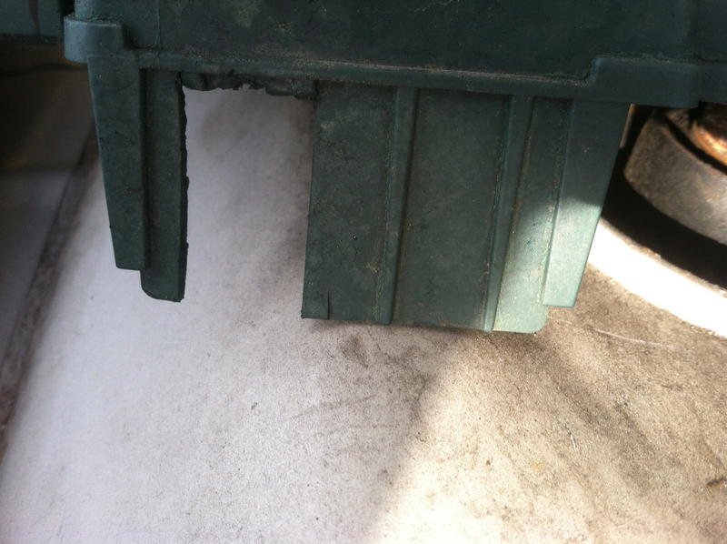

You don't want to hook it up to your headlights. It needs a dedicated circuit. Take your positive cable from the amp and run it the fuse box on the left side of the car. Here is a picture. Then cut a slit in the fuse box cover so that it will fit over the cable and close securely. This spot on the fuse box is like hooking it directly to the positive terminal of the battery, so its not sharing any circuits. Also there are pics of the my amp mounted on my back seat. After you get everything working you can go back and clean stuff up but I ran my wires under the seat carpet and cut slits in the carpet so they were not all over the place. Just makes it look nicer in my opinion.
I'll probably mount mine the same way. I just have it zip tied right now xD. Thanks for the advice, I'll be going out to tune it here soon.
That's interesting! Not negatively questioning you, but how do you know that's a safe mount point? Just wondering for future electronic installation stuff.
It's just like hooking it straight up to the pos of the battery. If you follow the cable it goes to the battery. It's before it goes into the fuse box. If it helps im an electronic technician. If you want you can buy a new positive terminal for the battery. They make ones with terminals to add extra wires.

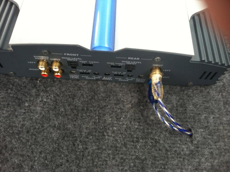

Check your fuse, ground, remote turn on wire. Did you sand down the grounding spot?
Old May 13, 2012
  #50
m3gach33zy's Avatar
Delightfully tacky. Yet unrefined
Joined: Sep 2008
Posts: 674
From: Portland
m3gach33zy is an unknown quantity at this point
I'm an idiot plugged the rca's into the wrong spot on the amp

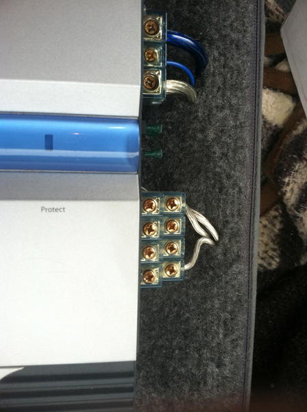

Any idea on what might be causing me to have to have the lights on in order to get the amp to power on?
Old May 13, 2012

Are you using the headlight circuit as the trigger to turn the amp on?
Old May 13, 2012
  #54
m3gach33zy's Avatar
Joined: Sep 2008
Posts: 674
From: Portland
I have no idea. I wired the p. control to the p. control wire on the head unit. Other than that I don't know where it's getting the idea that I need to have the lights on. + to the +.... - to the -.... I totally separated the power from the lights and the amp so yeah no idea where a wire would get crossed other than in the head unit area.. which I'm pretty sure I did right

The remote turn on wire should be hooked up to the ignition or a separate toggle switch. Like 01honder said, you must have wired that to the headlight wire.
Old May 13, 2012

You sure you didn't somehow wire it to the dash light illumination trigger? That's the only thing I could see that would make it come on when the headlights are on...

Just looked up the manual for your stereo, you connected it to the blue/white wire, correct?

Yeah. The only other thing I forgot about was how this wire was a different color than the others. The wire from the headunit was blue with a white stripe. The wire from the amp kit was solid blue, and the wire I'm splicing into is orange. Every other wire had a correct colored wire to go with it except this one which I spliced into the orange.

Orange is the dash illumination, bro. It would explain why it only powers on with the lights.
