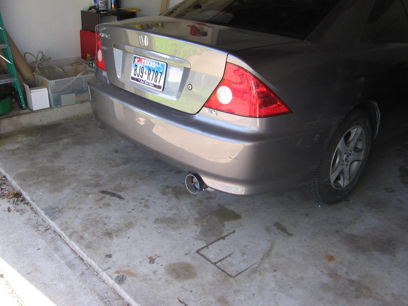

This DIY show how to install a bolt-on high flow axleback muffler on your 01-05 Civic.

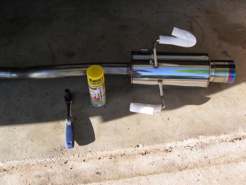

For this installation, You will need few tools: a ratchet and a 12mm socket, a bottle of penetrating oil like PbBlaster, and the new muffler as shown in Figure1.
1- jack up the back of the car and place it on two jackstands. Make sure the gear is in reverse, and place a stone or something in front of the front tires.

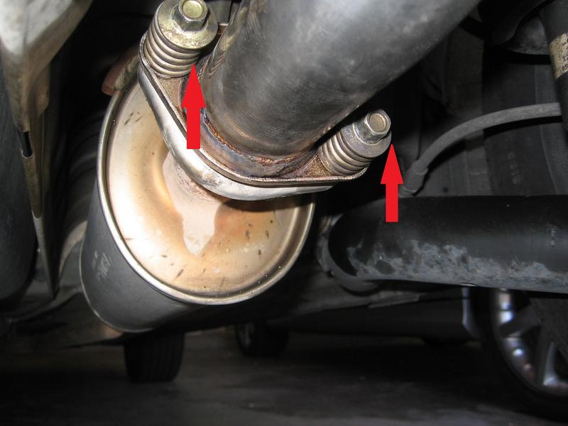

2- spray some penetrating oil on the two bolts shown in Figure2 that connect the muffler to the pipe, then wait for the exhaust system to cool and the oil to penetrate well.

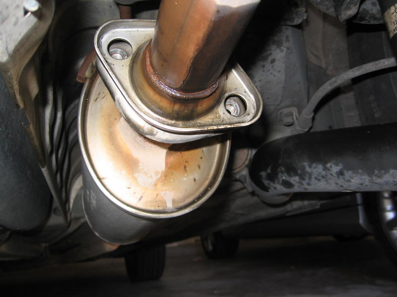

3- remove these two bolts using the ratchet and 12mm socket as shown in Figure3 and Figure4. These are spring bolts so you need to torque them few times before they pop out loose.

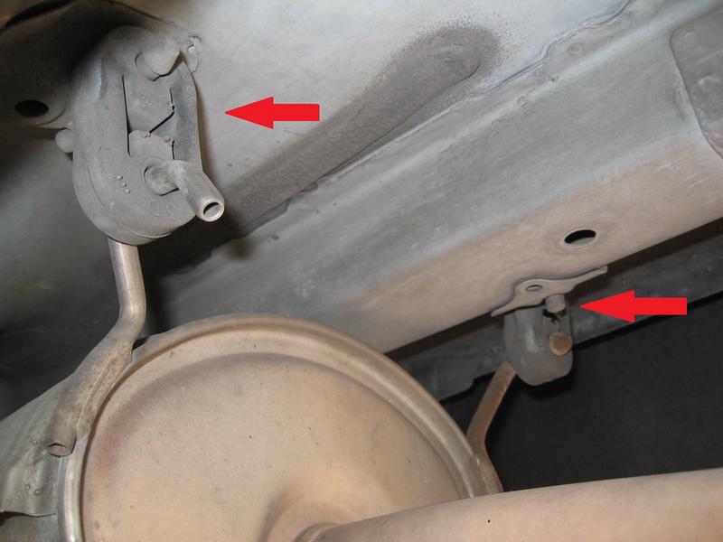

4- pull the two rubber pieces out of the muffler hangers as shown in Figure5. After that, you can take out the old muffler as shown in Figure6. Then move the two rubber pieces from the old muffler into the new muffler.

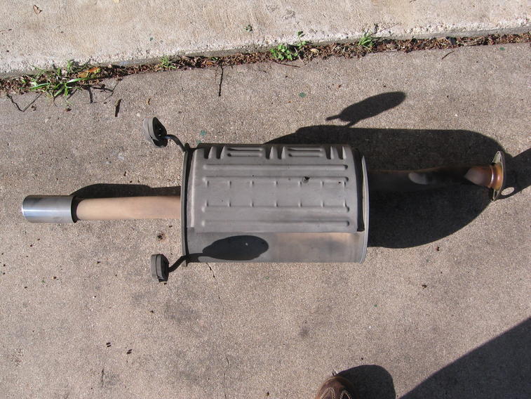

5- Hang the new muffler into the two hangers, then bolt it on the pipe
6- Turn on the car and make sure there are no leaks and you're done, as shown in Figure 7.
Now, enjoy the few extra horsepower, the nice look, and the deep sound of your new muffler
