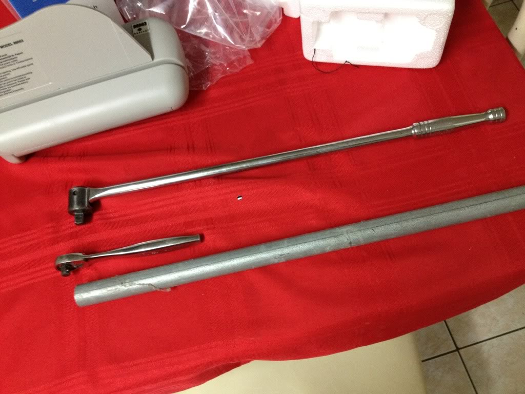

Hello,
My fluids from http://www.hondaautomotiveparts.com/ finally arrived on Wednesday. I purchased the tools mentioned by sl33pyriceboi from wallmart.
Ordered jack and jack stands from Amazon. Overall all the tools cost me about $100 .
Today I started with changing the coolant and power sterin and completed the same without too much of problems. Then I thought of changing the transmission fluid.
To be very honest , this is the first time I used the jack and jack stands. it took me some time to figure out the jack lift points , but after a bit struggle, i could put the jack stand under front passenger side jackpoint of my car. i could find the 3/8 drain bolt and i thought half of my job is done. But no! the drain bolt didnt rotate at all. It was jammed. After struggling for about 2 hours, I gave up and thought of doing more research before starting again.
Is this because the screw would have tightened by machine and not hand? I used the 3/8 wrachet.

yea, the screw is in there REAL tight..... you might need a breaker bar for that job.
breaker bar:
http://www.harborfreight.com/3-4-qua...FUgaQgodKA7R5A
make sure you are turning the bolt the right way tho (this is a common mistake when people are forced to work in awkward position....you should be turning counter clockwise.
if u dont want to spend $20 on a breaker bar, you can do it the getto way by sticking a tube in your wrachet and extending it for the extra torque.

actual $20 breaker bar on top, poor man's breaker bar on bottom. both work the same way.

the 3/8 drain bolt is toqued from factory, but due to being on there a long time and probably NEVER been loosened, it sometimes build corrosion and crap between the bolt and the socket...and pretty much gluing it together...
just make sure you are turning it the correct way or else you might strip the hole.
