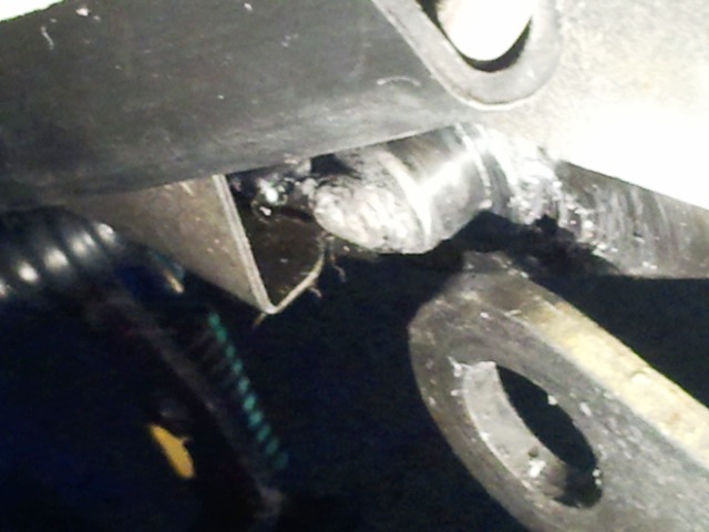

I completely damaged the studs when trying to tighten at 50 ft-lbs of torque.. maybe the metal of the studs got weaken.. I don't know. so I had it welded. otherwise it's good guide.
