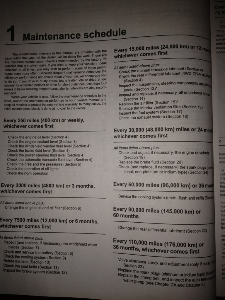

2). I told you to buy this book. Oil change is every 3000 miles (4800 km) or every 3 months WHICHEVER COMES FIRST!!
Here ill post some pictures.....................
Wow, all the maintenance right there? took me less than a minute to flip to the page
