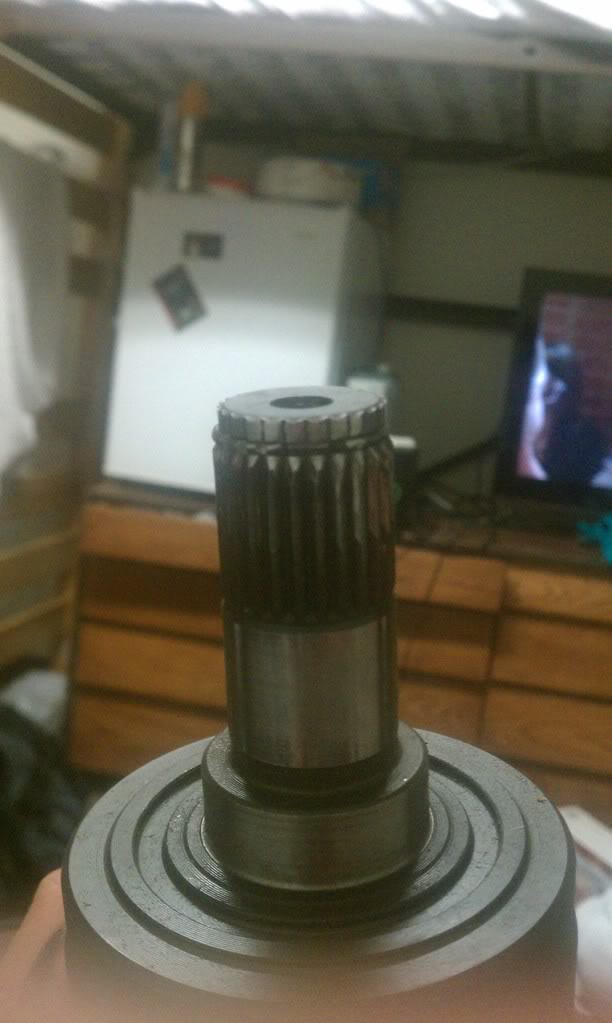

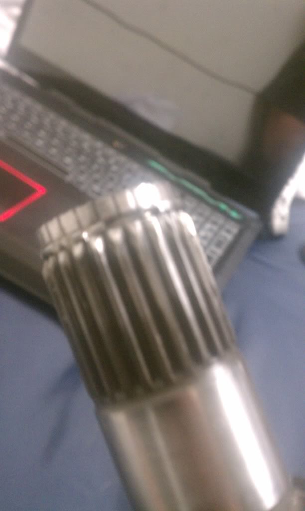

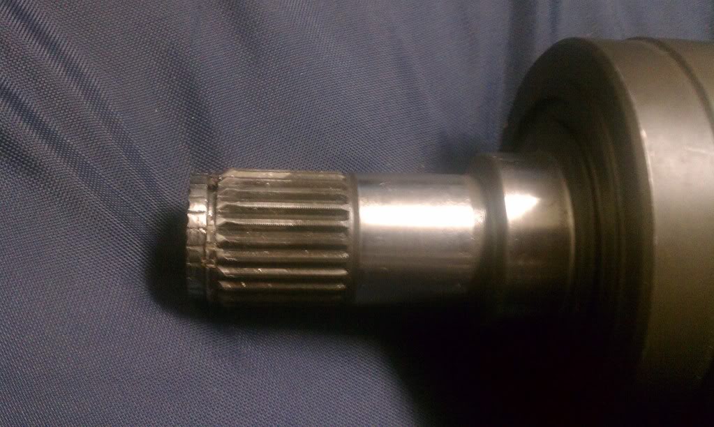

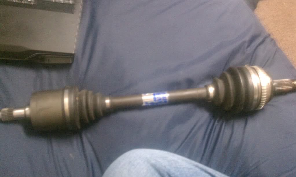

ill upload pictures when i get back to college tomorrow. I still have the axle
i think the snap ring should have been replaced after every time an axle gets pulled out of the trans (consult a genuine honda service manual to find out for sure), but it is rarely done that way in the real world. You may or may not even be able to use an oem snap ring on an aftermarket axle anyway, so it could be a moot point.
it is the correct axle for my car
That might make more sense, I'll wait.
but it looks like it was shaved down.
Any chance of getting side-by-side pics, comparing good and bad?

Re: Legal Advice? Help Needed. Calling all Members.
The color, bluing (if that's what you mean) in places is normal from the heat treating process.
The splines are what I wanted to see.
It looks like the snap ring is still in place, it just has been beat to death.
This looks like the shaft ran for a while only half engaged, judging from the shiny wear on the upper half of the splines, and the tips of the still intact splines have been twisted in the direction of forward.....then it slipped all the way to the very end and sheared the tips of the splines off under a load (a 1/4inch of engagement is not enough, apparently)....You got lucky there, the ones I have seen just twisted the end of the shaft completely off where the snap ring is. That's when REAL damage happens.
No way of telling if the snap ring didn't hold, or if it was an installation error.
Could have been either one.
I don't want to speculate or even guess.
Jeez, it's just too easy to get it all the way in and locked in place though.
But I have seen it happen both ways.
It ran only halfway engaged for a significant amount of time/miles to cause the wear to the splines like that.
Thanx for the pics. I guess it doesn't help your case any, but answers my curiosity.
This pic shows pretty good what I wanted to see.
