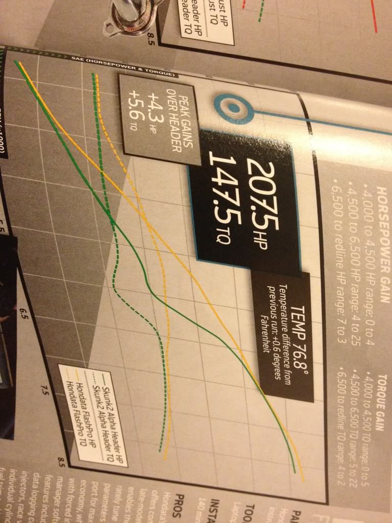

This is from import tuner. I believe these are resuus of a hondata system on a 07 civic si I think.

k20z3 then..
Incentive to swap?

Iwas just showing the differences before and after hondata

Oh, well, that's not a good example at all, sorry man.
That's a DOHC engine, the adjustments you can make to unlock power are different and much more effective than on an SOHC, because you have two cams to work with. Not to mention the higher displacement. K-pro is worthwhile, but you don't expect massive gains using it with a d17 that only has i/h/e. A d17 with a stage 1 cam I/H/E and D16y8 made 135whp with a good tune. Once you're boosted you'll be hitting 250whp with those supporting mods.
I don't give a **** what Andy says is possible, those numbers wouldn't even be possible on a high reading dyno jet. Playing devils advocate, lets say Hondata did make 25-30hp on an otherwise stock d17 with k-pro, they tune there cars at Churches which has a dyno that reads 30% higher than even other high reading dynos and the tunes run $650 an hour.

I know that d17 gains would be a fraction of the gains saw on that si, but if you only gain single digits on a k, then you would gain barely anything on our d. Oh well
