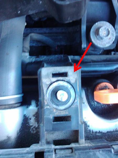

I have a honda civic 2002 and I want to replace the camshaft sensor.
I already read de DIY to replace it.
My problem is I don't know how we separate the connection indicateted in the red arrow (see the attach file).
Thank You

It always comes off for me when I take off the whole ignition wire cover. Maybe mine is broken, but whatever.
There's two bolts (10mm) that holds it down on the valve cover. Just take it off and pull it up and out off the studs from the throttle cable brackets.
Oh yeah, you can disconnect connections that's tugging it and the breather tube that's in the way.

I already remove the 2 bolts but it look like their is a clip and it doen't got out.

grab some pliers and pull it up as hard as you can it will come off.

I finaly separate it but now it is broken. Anyways still good

Small screwdriver works for me. Never broke any clips. But it takes longer and more of a pain in the ***

Good job. Now yours is broken like mine. No big deal, it gets bolted down anyway.
