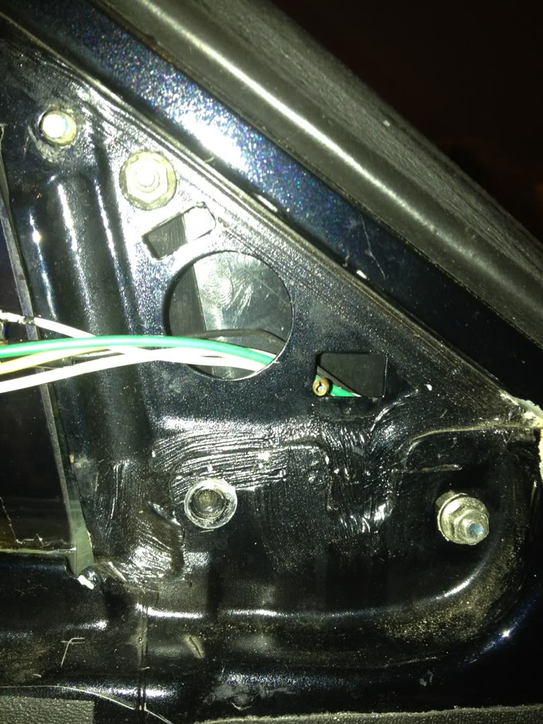

Mines an lx but ill take a look at it when I get home and post up some pics. You should too so we can see what youre dealing with. When I had to do some wiring for my mirrors I remember 3 8mm nuts, but idk.

Re: g2 mirrors

ill get out there tomorrow and take a few pics and hopefully get them on but it looks just like urs slimrisk. that bolt on the top left of your pic is the one that threw me off when i was lookin at mine. i guess that bolt doesnt actually hold the mirror on?

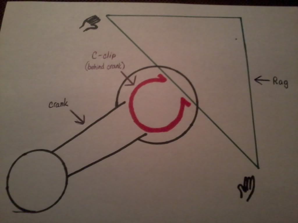

Originally Posted by SlimRisk
I would have no clue how to take off the crank
Crank! Who has F'ing window cranks anymore? lol
To take a window crank off (the simple way):
1. Take a rag and fold it into a triangle.
2. Grab the rag at either end of the fold you just made and pull it taut.
3. Now, work it behind the crank and use it to work the C-clip out.
Here's a drawing as an example (sorry, no skills. lol):
Works 9 out of 10 times.

ahh...ive heard of people using a rag but i wasnt sure how. thanks man
