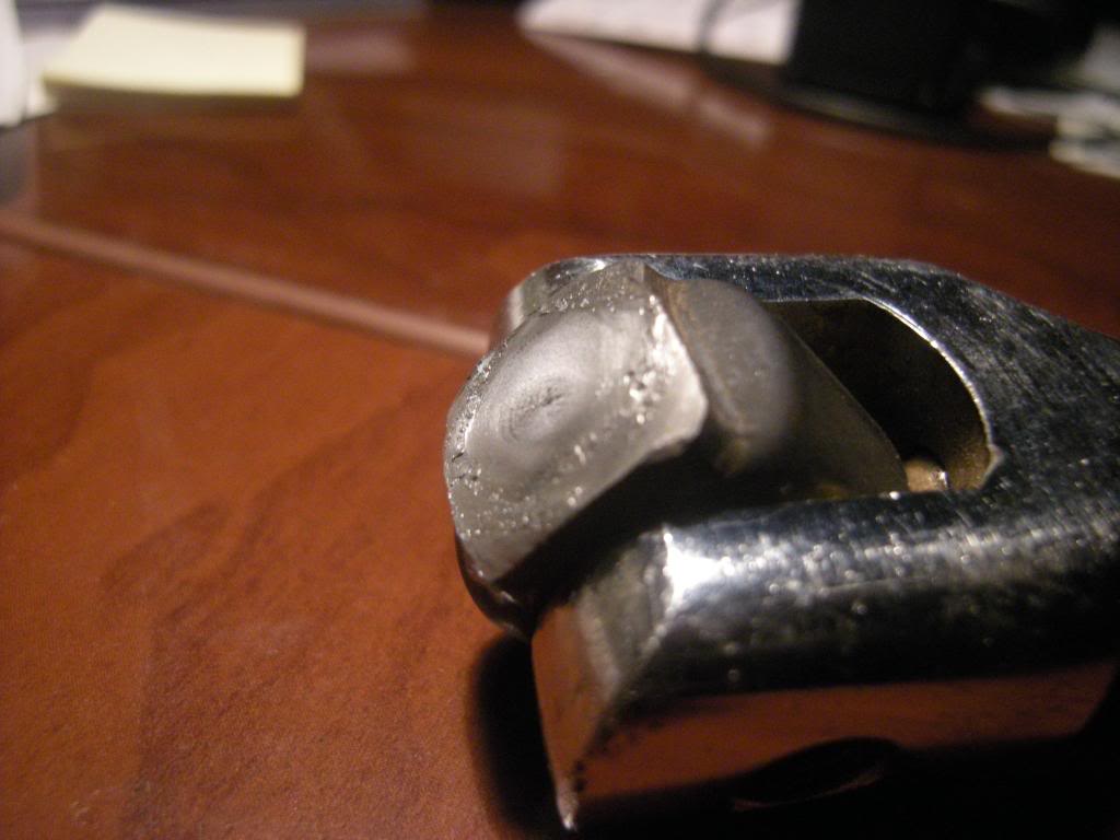

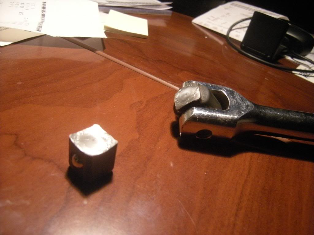

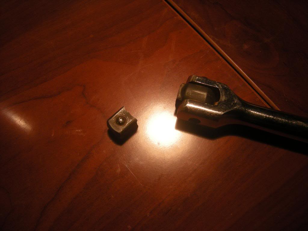

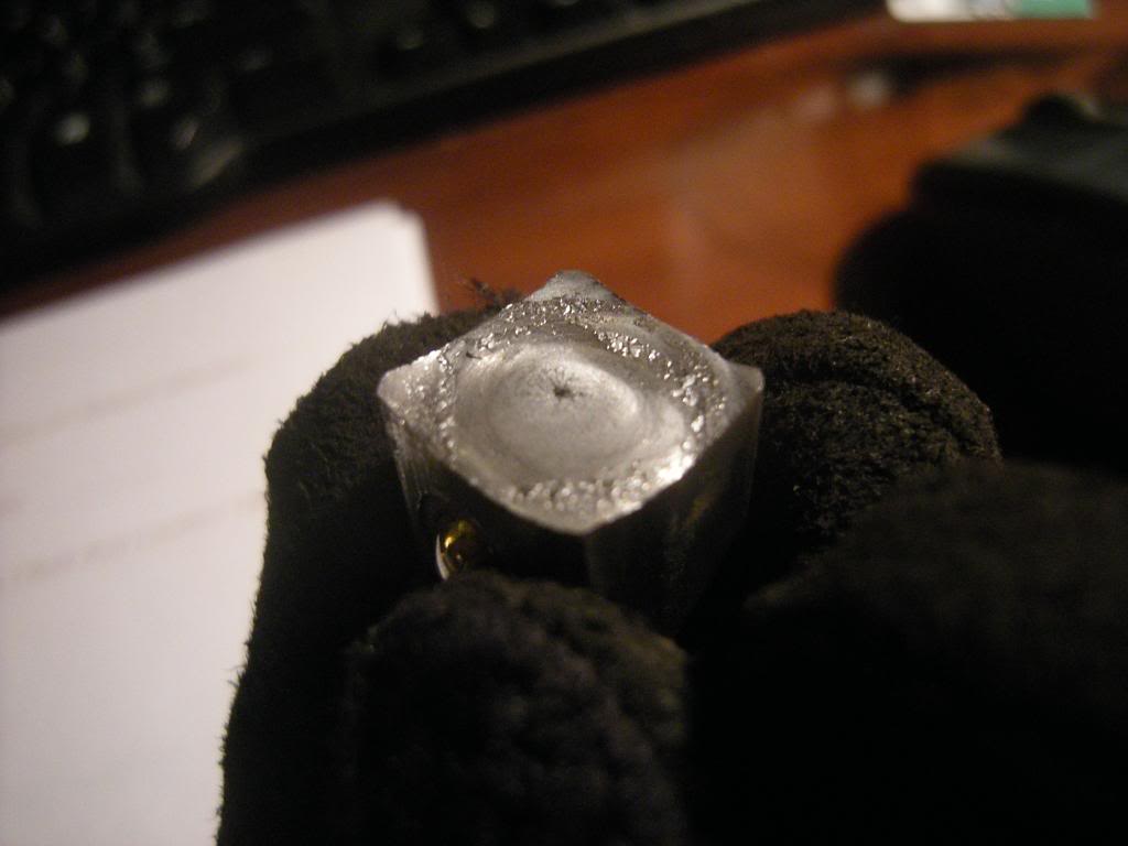

So, I started my journey with the 5 foot steel pipe extension. still wasnt budging. used more force and heard a cracking like sound. backed off and noticed that the nut didnt turn at all. I thought I mightve broke the axle. started forcing some more, and bang! pics describe all...

Oh yeah and this is wierd as hell... I read that the nut was a 32mm, so I went and bought a 32mm socket. had too much play in it so I returned it and got a 31. worked fine with only a slight bit of play. I tried to see if it would fit on the front left and it was too small. Say Whaaaa?? Im so confused. Im thinking that when the car was in its major accident, it had to have the knuckles replaced and the nut they put on there had the same thread, but different size than stock.
EDIT: My old breaker bar was a Great Neck brand. Went to autozone and returned the breaker bar and they gave me a duralast because they dont make the one i own. Started wrenchin and broke the duralast one too. Just gonna go to my school and get it off with an air ratchet. The big question I have, is what way do I turn the nut? Lefty loosy, righty tighty?
