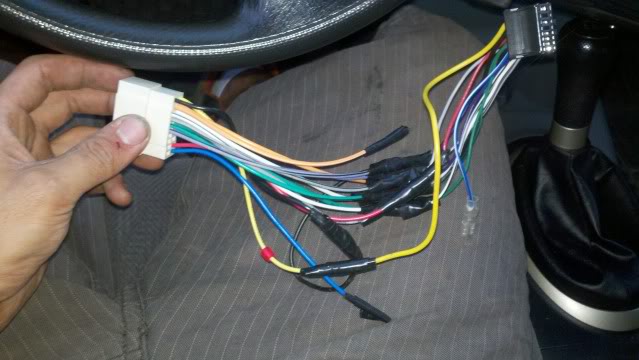

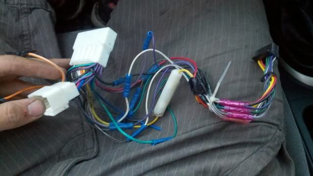

pictures below are for the same wiring harness from a pionner top one is from the 99 sedan ex and the bottom is from the 01. I dont know why the 01 has split from the one connector to the other one then does to the plug connector?
HELPPPPPPPPPPPPPPPPPPPPPPPPPPPPPPPPPP! im lost
picture of the wiring from the pioneer aftermarket raido in my 99

picture of the wiring from the pioneer aftermarket raido in my 01
