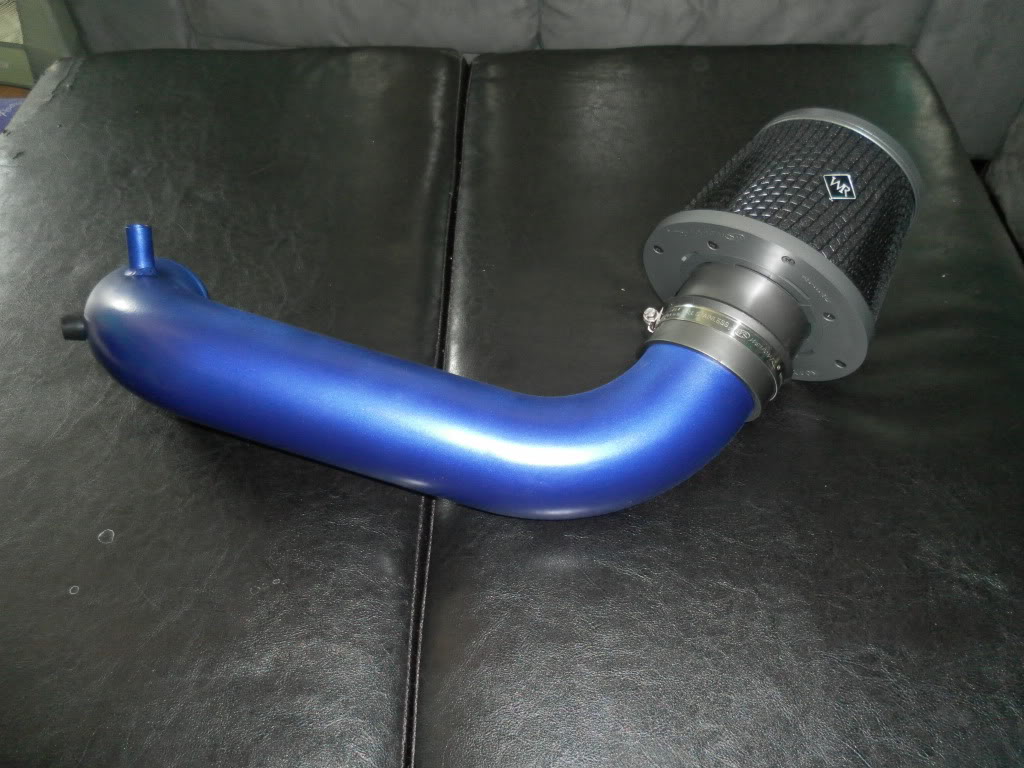

Stage 1 cam is the only way to increase horsepower unless you get KPRO. As soon as your getting Kpro your looking at 1500+. A header and intake will make no gains whatsoever. Brand of intake also makes no difference at all. I made one for 90 bucks (Canadian) by ordering parts here and there from people. It's not AEM but it works.

If your going to get a header DC is best but Megan is a much cheaper and still quality choice. Change the timing belt and water pump if your due (100k miles) or coming up to it.
